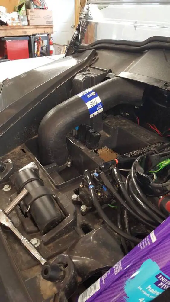

as for the intake, I cant take full credit for it. My good friend @joeymt33 Invented the Idea to fix the water ingestion to our lovely 16’s. Simply put, where the intake is under the hood you get a pice of aluminum pipe the same size then a fernco to connect it then cut it to the size you like. U can put whatever top cover u like. Some like a cone filter. I like what joey and i have as the true snorkel look. There is a documented section my my P1 build on it for further reading if u want.
My machine is the 2022 Trail. Do you think there is any advantage to run in the pre-filter through the hood?

Thanks for the complements.
Do you happen to have a link to the snorkel top all of you guys used? Thanks in advance.
The '16's had a bad design of the cover for the pre-filter and air intake. I don't think that is much of an issue anymore. There is no way in hell that I would cut a hole in the hood of that beautiful machine!
It was basically the 16’s and some early 17’s had the issues. People did other things to rectify the problem. You like all later models have a deverter on top of that intake. You can remove it. Nothing wrong with putting one of these on, its your machine. Weather it be that your going into some deep $hit or just want to look BA its up to you.
I think it would
Look good on your trail imo but thats me. Ill have to look up the top for you. Been a while.
I think it would
It definitely serves its purpose very well and looks kinda old school cool, just not for me man.
Heres the very original where I got the idea some yrs ago. Also the link to the build. Post #130 starts with the snorkel and parts list in there. And yes, he went through water that deep lol. Not often tho haha I couldnt find the pic of him submerged with that
