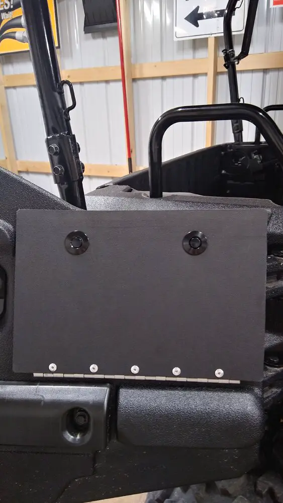

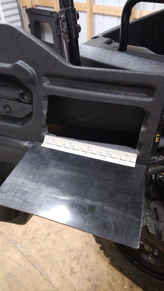

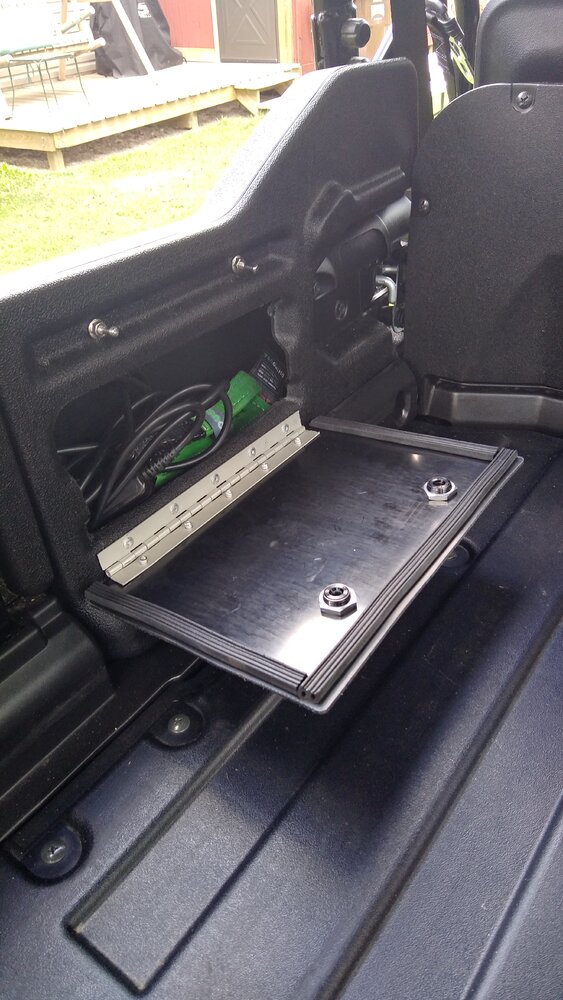

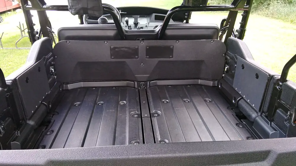

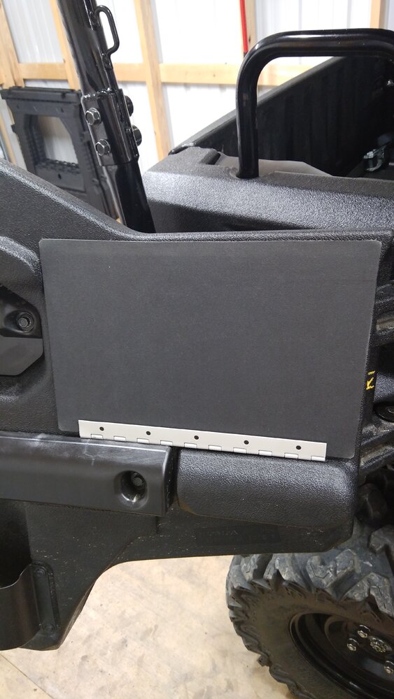

Using the idea that I saw in the forum from another member, I cut the doors out on my new 700-4. I cut it out a little differently and mounted the push button latches inside the seal area, so I could get a good seal around the top and sides. Later, I may put some RTV on both hinge sides and let it cure. Then when I shut the doors the hinges will compress against each other and the RTV and seal the bottoms good also.

Where did you get that plastic and push buttons? Awesome work!!
I got the plastic and hinge on Amazon and the push button snaps on e-bay.

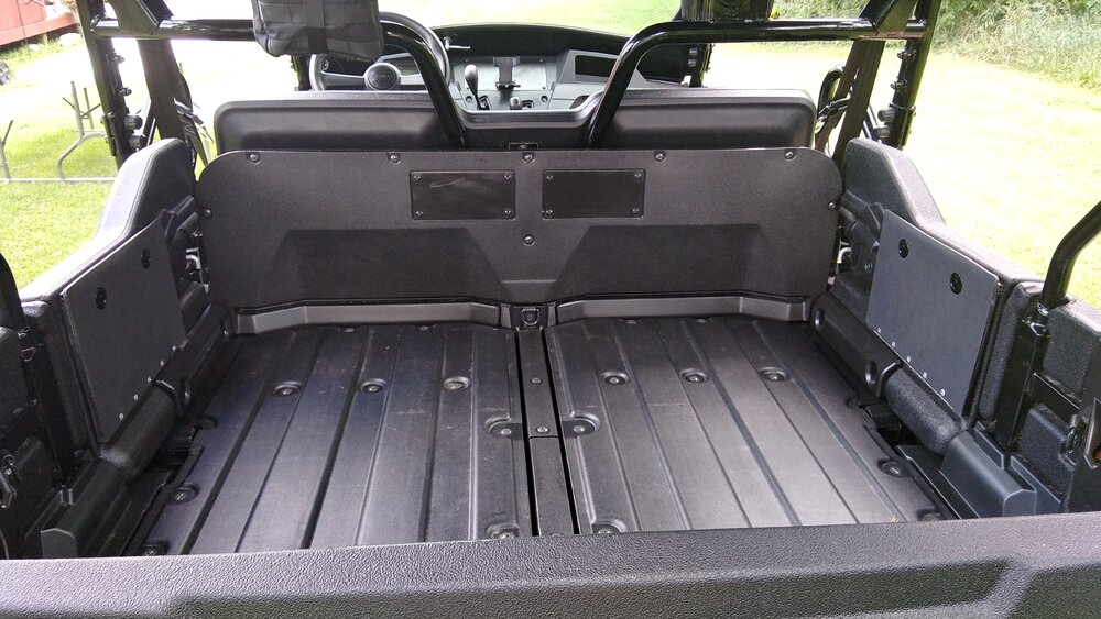

I had some 3/16 Aluminum diamond plate sitting around so I made a couple panels with that i stead of plastic sheets. Hopefully it won't be uncomfortable for the rear passengers. It sure looks nice though.
