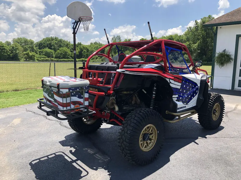

Also could consider a roof rack but I think you would have to fabricate that yourself.
@TerryH built this...
The modded Harbor freight cargo rack has worked perfectly for us so far. Like it much better once I narrowed it to fit the cooler even though it was ok in the original width.
One advantage to our setup is the HMF rear bumper with the integrated hitch. HMF has the hitch mounted much higher than those mounted at the radius arm bolts. Give 20" clearance on the rack.

Thought of the hitch rack, looks like their's has a raise to it, the one I already have does not and I thought I it would hit the ground in places, I will take a look at it
Definitely an advantage to the HF ATV rack. It does have an up turn. I also had it coated with bed liner after I narrowed it.
