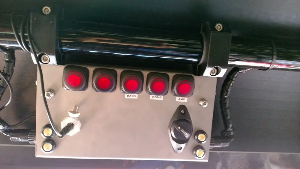

I also made a roof out of 1/4 " and used the Honda quick clamps to hold it on,I love it, absolutely no rattles or vibration, it doesn't touch the roll cage anywhere, it sets on top of the clamps away from the cage.

My clamps aren't very "quick" but I don't have a need to take my roof on and off and I have all my switches mounted overhead anyway. I needed something pretty sturdy because I tend to get lazy and not clear trails so tree branches do a number on it. Tue factory Honda roof probably wouldn't fair to well on my ride...

Here's my clamps....
ATTACH]
IMG 20160325 185115 821

Part #08R70-Hl3-A00 ,order thru Honda dealer, about $8.00 each.
