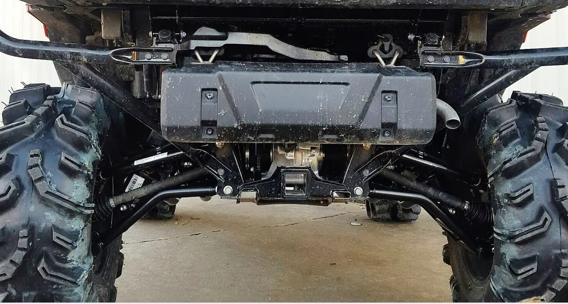

@aquatic1998 I am running the Strong Made 2-3" lift it is $162.00, today I mounted 30x10x14 STI Roctane XD tires that are 30.4 inches in diameter. The only rubbing I have is from the UHMW skid plate that protruded 2" into the OEM front wheel well. The Outlaw 31" tire is just over 30" like my tires according to other pictures etc. This may be an affordable option for you. I now have 16" of ground clearance after the lift and tires. Detailed pictures are on the last page of my build thread below in my signature.

I am at 81" just shy thereof, with the lift AND 30.4 " tall tires. 79" without bigger tires. OEM is 76.5"
Full measurements are in my build thread, posted today.

Well, I found another set of 31's and just put them on. Yep. They rub on drivers side at full turn. I even heated the plastic up with a heat gun and tried rolling it back. If you want bigger than 30" tires, don't waste your money on a stronghold lift.

I would agree on that. I got my trail armor UHMW skids trimmed back and my Roctanes are 30.4" and they too rub ever so slightly at full lock on drivers side only. That is with the machine leaning in a robust left turn. I have a heat gun that goes to 800 degrees and will push back that protruding corner its only an inch or two wide where it touches, moving it in 1 inch will make all the difference in the world.
As it is now I would say 29" tires are the largest you can safely fit using the Strong Made Lift without any modifications, other than that if you ran 4+3 offset that would clear as I am running 6+1 offset, but note a 4+3 offset will put you at 67-68" wide in the front. Hope that helps people make the right choices with that lift kit.
