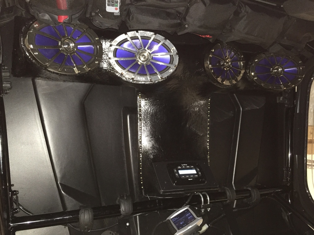

I had a fiberglass enclosure on my 700 that weighed about 55lbs sounded good but heavy.
C5179f0900d0434d4591130694a51139
I’m going with the WetSounds Surge 6, Ww-BT RS, and AS-8 sub.
Total it’s about 30lbs and 20 of it will be mounted low. Little weak on the midrange but it sounds really good and actually is IP-67 rated which is pretty good.

I agree with your concern about weight, especially up high. The SSV enclosures are slightly larger than each speaker and weigh about 1/2 lb. ea.. Mounting them under-dash keeps weight down and minimizes the cantilever effect of weight up high. I also want the option of being able to remove the roof without any adverse consequences, although I probably never will!
