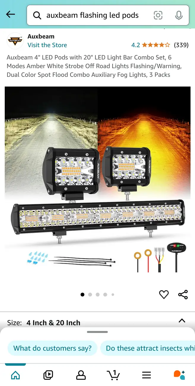

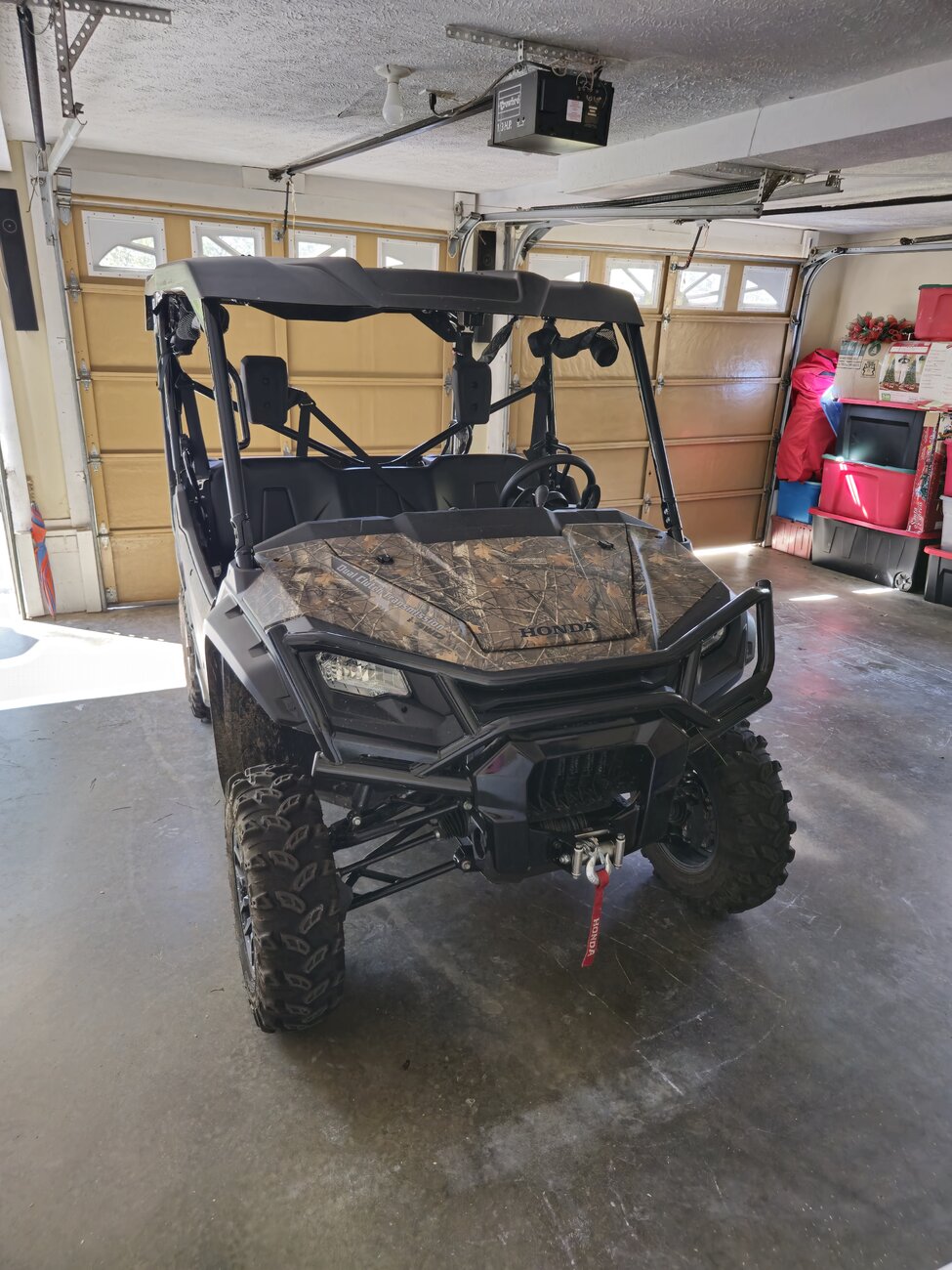

My p1000 came with a winch wired from the factory so im not seeing the need to rewire to the aux battery but I may. I have two sets of the attached light bar and pods for front and back but I need the second battery and the isolator kit as well.

There we go! 👍🏻 Nice rig, I like the Camo.
If your running a winch plus the other stuff, Id hook it to an aux batt. These Hondas are voltage sensitive for the DCT etc. its good to keep the main battery for the OEM things of the rig as much as possible and Accessories to a second battery with true isolator. Youll be better in the long run 😉
