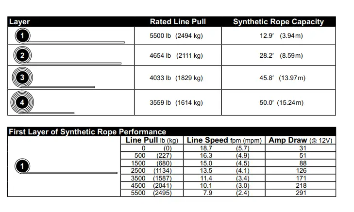

18,690
68,377
Update... You need a 300 amp fuse.

18,690
68,377
That is good information. I am going to look into replacing my fuse as well.
I am not an expert, but there is a lot to consider.
My research suggests a fuse may be nothing more than a feeling of false security.
If you installed a 100a fuse, you may blow it while winching.
If you installed a 200a fuse, you may blow it while winching HARD.
If you installed a 300a fuse, you are protected from the winches listed max draw overload.
HOWEVER....
Can your battery even handle a 300 amp short?
If not, the battery itself becomes the overload protection point due to loss of power.
Example.
The GYZ16H is only listed to produce 240 CCA's.
That means the 250a fuse is useless in this system.
So.. bottom line, install it if it makes you feel good.
Ok.. Just things to think about. lol.
