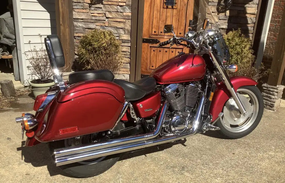

Went with this option for the Honda motorcycle to ride today, partly because O’Reilys gave $10 off for each of 3 dead Pioneer/atv YUASA batteries cluttering up garage. It is 220 CCA vs 240 with the GYZ 16H. I have a charging pigtail on the way. The new battery has threads tapped in the lugs, no fumbling with the little nut. A good time to clean all connections.
