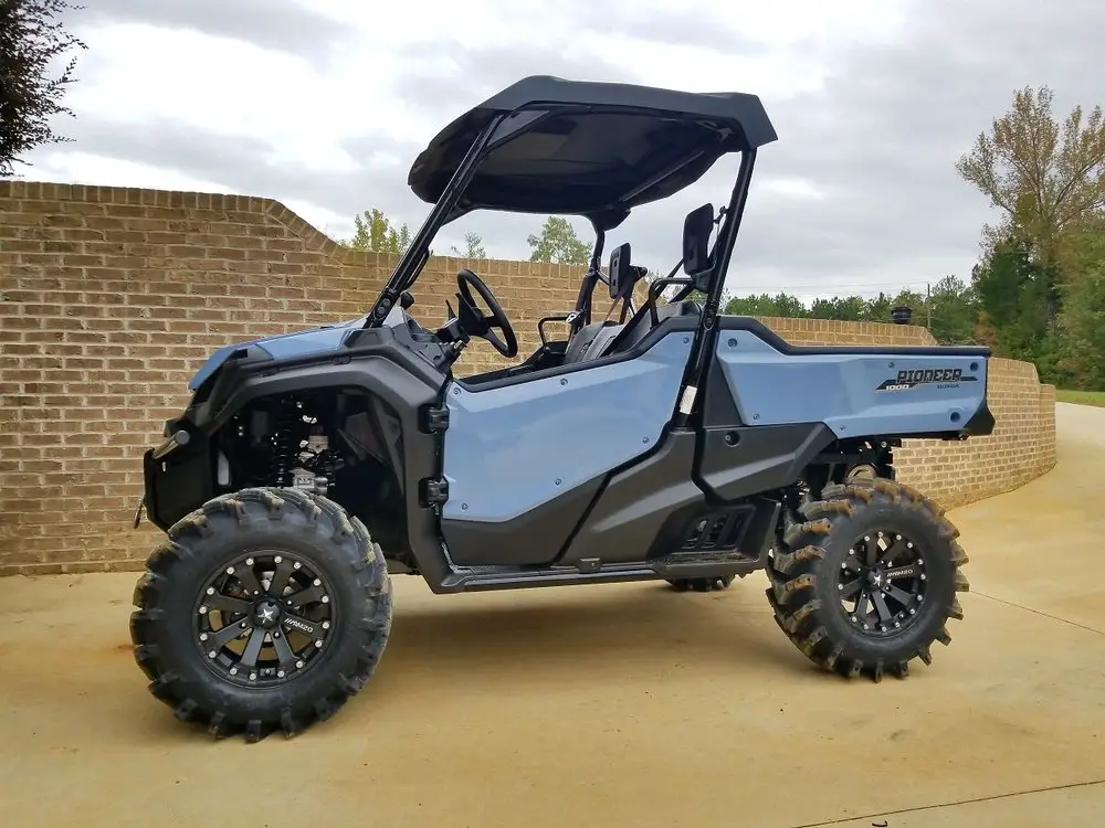

28x10x14 outback max mounted on 14x7" wheels on a 3.5 offset on all four on mine.

Ran both offsets. 5+2 and 3.5s. Like the 3.5s the best. Gives a wider footprint.

Yes. 1” in front and 2” in rear. I’m about 68-69 inches wide. Very stable.

You need to run a 1 “ spacer in the rear when you go after market wheels to even up things. I had the spacers already so just used them.

I’m running 1” on fronts and 2” on Rears. I really like them. Just use locktite and cross torque to 82 pounds. Mine as never loosen up! I believe you will be pleased.
