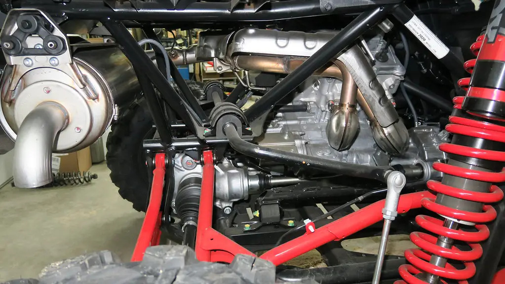

Rzrs, can-am and the Kawi KRX all have better OEM suspensions. I also ride the rockies, width isn't a problem and why I bought the Talon R, more suspension travel. Something that will help either Talon is unhooking the swaybar on rides that will see lower speeds. This is because a sway bar connects both sides of the buggy, both spring rate and valving. Someone makes an easily removable sway bar link set. On the Talon X, I think you can just remove one SB link and ride but the R has a more complicated rear suspension and the SB end will hit the upper trailing arm if you don't remove both links and tie the SB up.
Extreme riders say that low range is too tall and I experience that 'on occasion' but it's easy enough to ride around that 'problem' by gently bumping an obstacle. But I'm not an extreme rider either except for my summer altitudes - up to 13,262 feet so far. The DCT is so much fun to drive
that I'll learn to live with the shortcomings that come with a Talon.
Beadlocks let you run lower tire pressures which helps a lot with the ride quality.
You can see that the SB will hit in this picture if it isn't tied higher.

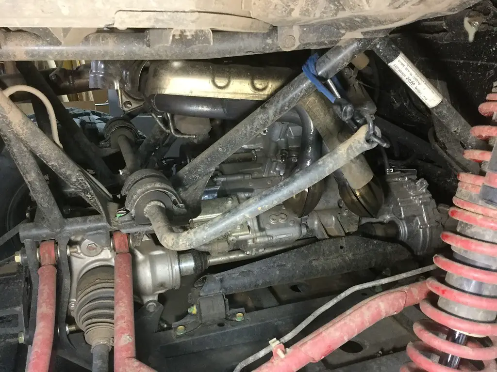

Bungeed up out of the way -
You can see the white SB link in the up/disconnected position here -
