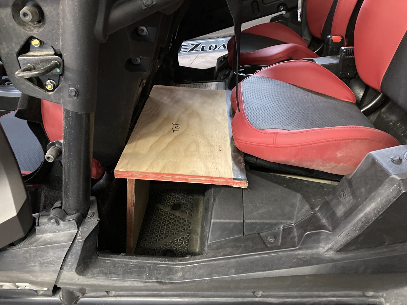

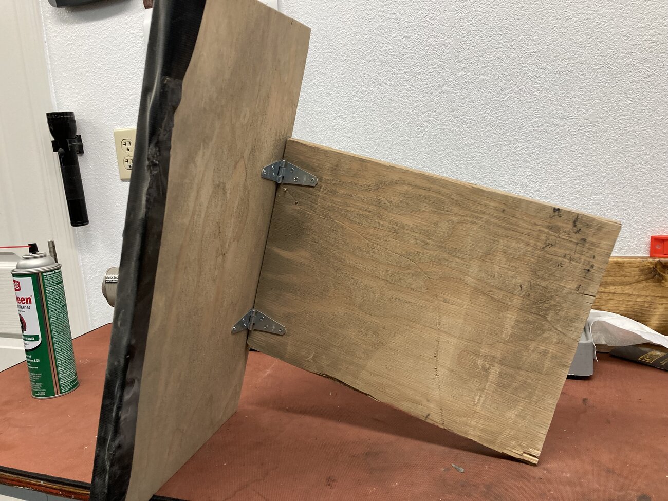

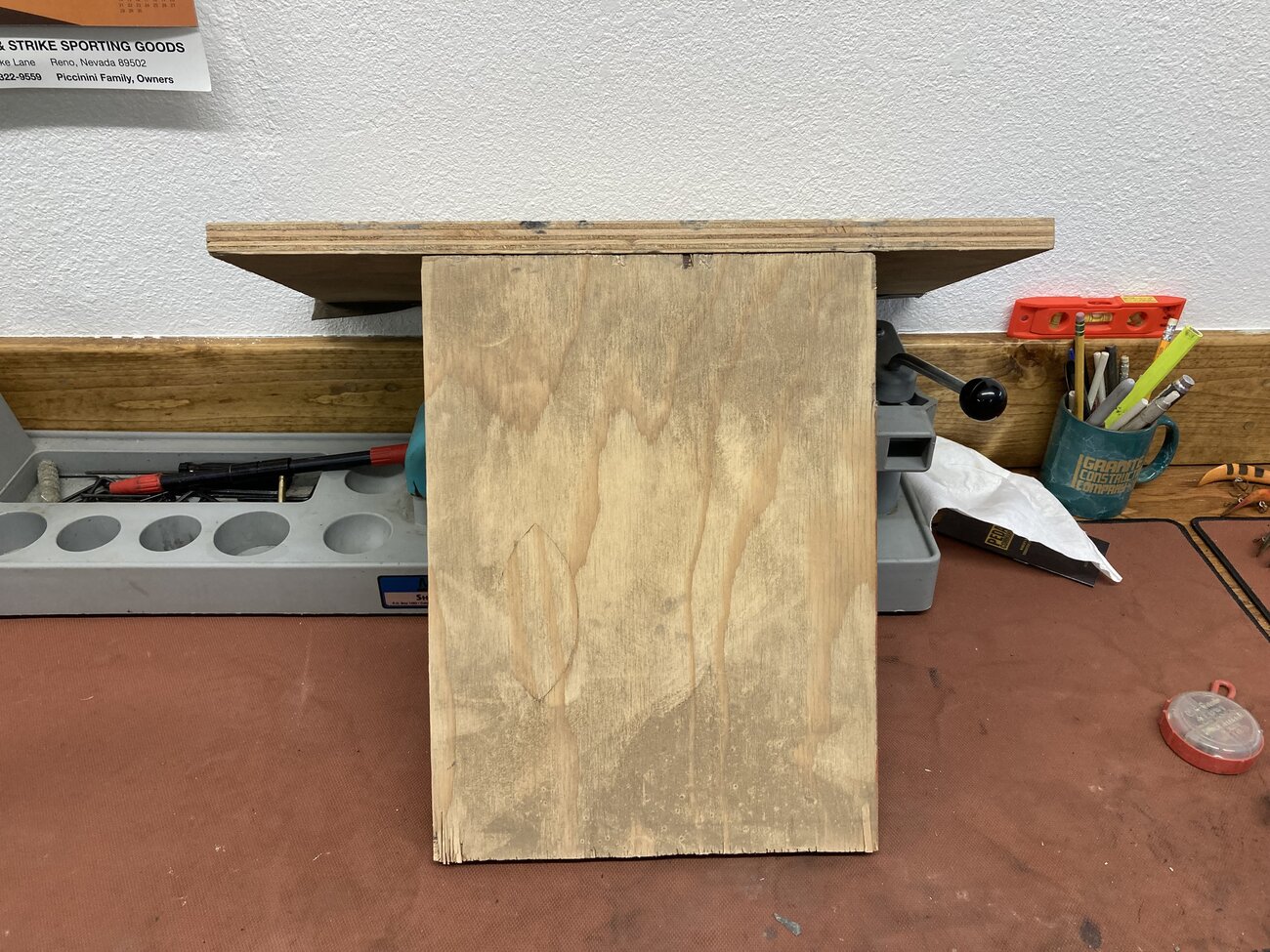

our dogs are the same,i built a couple of platforms that fit the same height as the rear seats, put some 2"foam and a thick blanket in the back for them. the platforms where easy to build four small hinges and some plywood, i can send you a pick of them and dimensions if your are interested in building your own. thanks, big creek is a wonderful place, i brought our 5th wheel back this weekend we have a spot in town we leave it there for the summer

I’ll get them to you tomorrow. i used 3/4" plywood, top measures 20"wide X 10 3/4" deep. leg measures 14 1/2" long 11" wide. the hinges are 2" a piece of gorilla tape on the edge to keep the splinters off the seat. put a piece of 2" foam on top of these to match the seat height then a thick blanket of the top of it all. cheap and easy works good for us. u still have storage underneath. hope it will help with the furry children.
