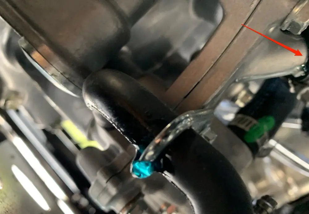

Mudwing- thank you.. I just assumed it was overflow- HAHHAHA - how out of tune am I ??. Well I sent an Email to the selling dealership - they have to pick up and redeliver to me as it won't fit in my truck. and it has 3 miles on it- bought in summer parked until the snow flies to plow my driveway.. and then this ?? ugghh

I really would hate to see you waste $100 on pick-up and delivery.
Any chance you can take some pictures and post for us to see? Will let us make some recommendations on how to proceed.

I had a similar leak on my new 700-4. It ended up being a loose clamp on a coolant hose (as I think was already suggested may be the case here). Below is the link to my issue and the good help I received on it from the forum members. Been perfect ever since.

Ok with your help -- You may have saved me some grief..
Took it in my garage cleaned it.. let it idle.. and it's poring out of here- I think I can just tighten it.

Took it in my garage cleaned it.. let it idle.. and it's poring out of here- I think I can just tighten it. View attachment 94184
Nice! You saved a hundred bucks and your bike being away from you. If you could post pics of it fixed, please.

Crap- this particular clamp was in a location- you MUST remove the floor plan (skid plate) I removed it - tightened it up cleaned the skid pulled it out and let it run, no more blue.
Yes saved $ and the fact I need this rig 'now' for my plowing which we are well underway!
Thanks guys! Very excited this wasn't an inner seal etc.

Kinda nice to wrench on your own stuff and save money right?

I had a feeling you were talking about the weep hose...
Glad these guys sent you in the right direction.

Yes- Thanks everyone- I'm a novice at best and kept saying all night- I can't believe I fixed the leak?? (this from a homeowner with a pan under a sink in the kitchen) Saved a ton of aggravation.
Been going through alot with family health etc and my head just wasn't in to what was really leaking ;) I'm thankful for everyone especially on this forum!!!
