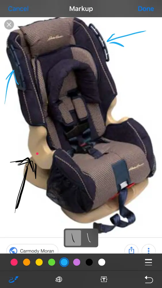

IMG 4087
My wife is looking for a pic of our seat we had. But this is close. The pink spot is where I drilled hole low to keep it tight to seat... up top I used to bungees without hooks. I took off the hooks and used parachute cord.I took the hooks off in case the strap came loose it wouldn't swat my boy or mom... it was major over kill.

View attachment 70090 My wife is looking for a pic of our seat we had. But this is close. The pink spot is where I drilled hole low to keep it tight to seat... up top I used to bungees without hooks. I took off the hooks and used parachute cord.I took the hooks off in case the strap came loose it wouldn't swat my boy or mom... it was major over kill.
lol. Better safe than sorry.
