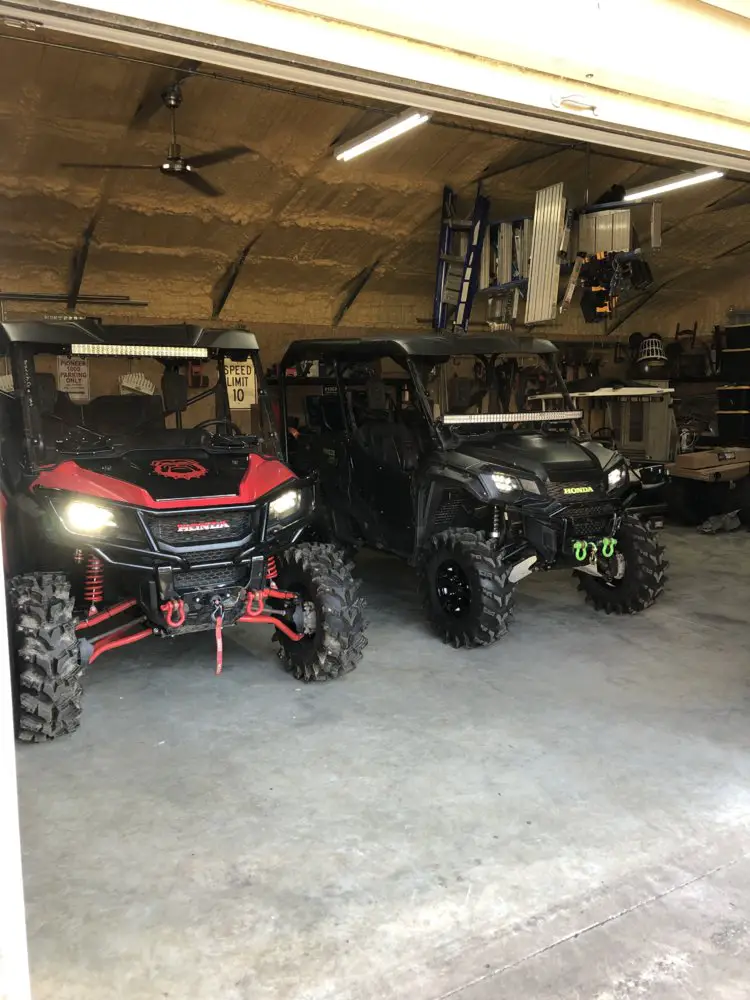

My buddies wheels came off a Commander. Had to have spacers front and rear but work great then. 1.5” front and 2” rear is what he has
@Pellicer96

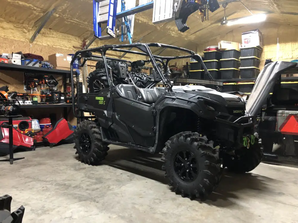

I have set as spare backups. The offset is different but I have spacers. Also the Can Am wheels have tabs that may need to be ground off. Depends on the diameter of your spacers. I do have one mounted right now due to a flat.
