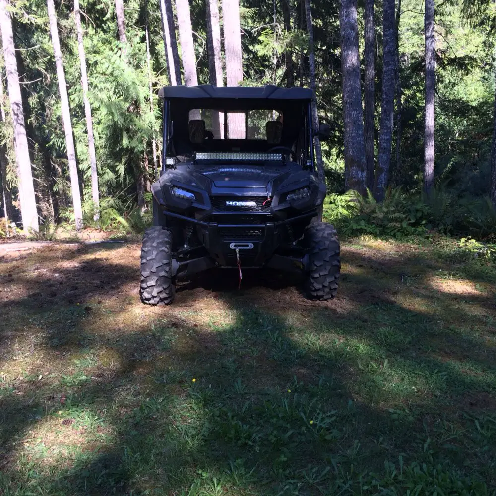

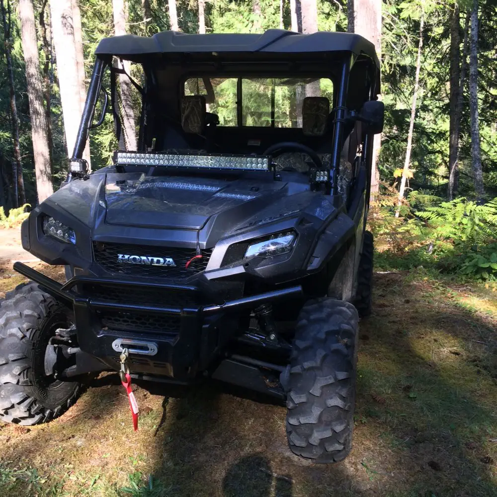

@500 - I finally had a chance to play with the pioneer today. Maybe this is still useful for you...
The front width is 66.5. With 1" rear spacers, the rear width is 67.
Front view - the width of the tires looks exaggerated.
Looking down the side - you can see the rears are a bit wider than stock wheels and stick out a bit.
Leaning out over the drivers door, you can see the fronts stick out a bit.
That bit of extra width makes the machine feel alot more stable.
IMG 3124IMG 3126 IMG 3130
Edit: fixed typo 67 - not 77 rear width
The front width is 66.5. With 1" rear spacers, the rear width is 77.

Thanks.
I take it you dropped the front spacers?

Thanks.
Yeah the extra spacers was an experiment. The stability was great but not that much different without the extra inch all around.
Decided not worth it - getting a bit wide on the trails and risk of wheel bearing wear.
Dang! 77" huh?
Looks good, 30" EVOs?
Yup .. 77 - that was with my 6 inch spacers - lol
28" Evos. Same as the 30s just a different label from what I hear.

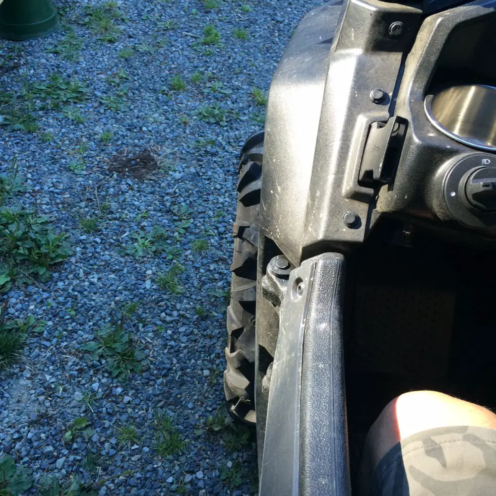

I have the Evo 28's on stock wheels, stock suspension and they have given me noticeably more clearance... no rubbing.

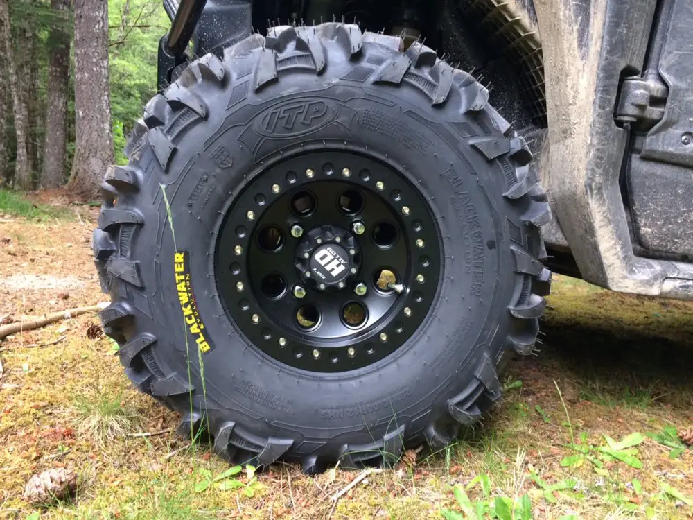

put 28 10 14 on and all is good also put bead locks HD5 5/4 rims works fine.

OK the rim part # is STI Beadlock 14HB279 5-4 offset 9 Inch rim 28 X10 tires will try 30 next time maybe.
