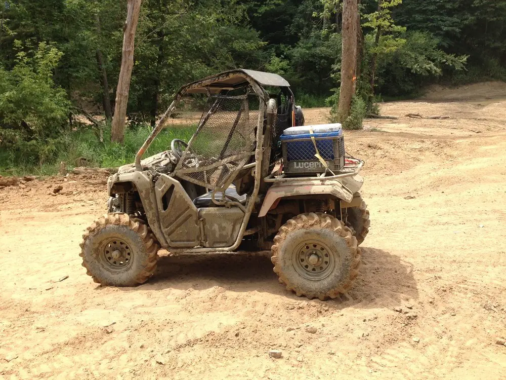

So I went riding Saturday and had two different issues that put me on the trailer. Rode around for about 30 minutes and after going through a watery muddy hole at speed the steering wheel started to get really stiff to turn. A buddy said his kids 800RZR does the same thing when it gets water in the rack, he eluded to it hydro locking.
Now, this also happened to me 3 weeks ago (after a big puddle) and since it was at the end of the day I just parked it and the next day it seemed fine but I had no major ride that day, just loaded up after a ride around to see if it was still messed up, and it seemed fine. I also rode it around the yard during this last week to be sure it was ready for a big weekend outing and all seemed fine.
Also when I headed back to the trailer I noticed it pulling hard to the left, kinda felt like a flat tire, it started to squeal like a bearing was going out.
So, I came home and pressure washed everything last night down and this morning I did a basic inspection and other than a few torn CV axle boots all seems good. I cannot get the problem to replicate itself. It turns well and the wheels spin freely. The gators on the rack are not damaged and I cant see any obvious issue. I am going to guess that the squeal from the front left was from rocks jammed into the caliper area and after the wash the issue resolved itself, it could have been a rock wedged between the rim and caliper for all I know. The wheel free spins and has no side play or slop in the bearing.
But the rack and the steering issue is a big deal, it gets wet and I cant steer. I cant have that.
I don't want to load this thing up for another ride only to go back on the trailer. Has anyone else had the steering issue?
Can someone with a service manual look and see if the rack has a grease fitting that I can use to purge any water out of it?

My foreman acted exactly like that when my left front CV started locking up from riding with a torn boot. It'd be fine one second then bike would pull hard left and be really hard to steer. I'm mentioning this cause you said it had torn boots. Just a thought.

This. If you have torn CV boots my bet it that you have an outboard joint going out that's causing the pulling and steering issues.

I agree, good call. I took the axle out and then took the CV apart for inspection, it was full of water and dirty. It had to be the issue.
New boots are on order. Now I need stick stoppers, but man those are over priced.
