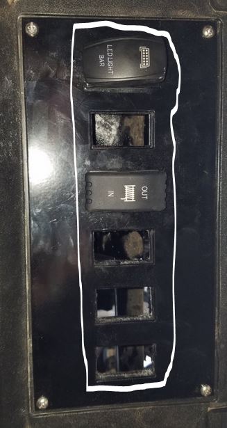

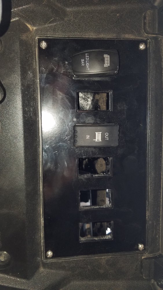

The plate from pbr arrived super fast. Quality product. Metal with a nice paint job.
I drilled the rivets out with a 3/16 drill bit, the warning plate peeled off easily with help from a putty knife. I traced the slots for the switches with a sharpie and then cut out the plastic with a Dremel "plastic knife" torch. Worked perfectly.
All in all, it was a great fit and I am very happy with the PBR dash. Here is a picture of the rough draft.
If I remember, I will send the picture of my dash plate finished.

Did you make individual holes for each switch?
Might be easier in the future if you make the hole this big.
