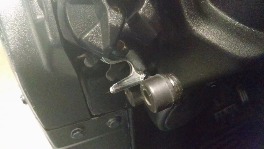

Could someone take a picture of these rubber stops? I believe my P500 is missing them. The more I pull it the bike apart, the more issues I discover.
Reactions: JTW
R
Rustell
this should help..
Door stop
Reactions: doolin64

I found the part # the microfiche says there's 4 of them. Where's the second one on each side?
