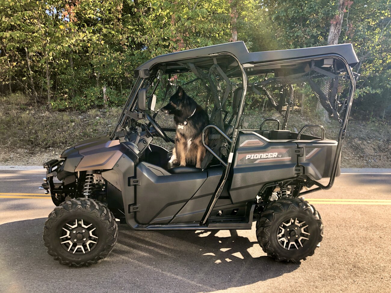

Going Street Legal so going to LT Truck Tires and new thus new 15" Wheels. I like these Hostile 109's.
I measured the wheels and the 110mm for BP1is accurate. My front tires are 25 x 8 - 12 & the rear are 25 x 10 -12.
Therefore I feel I need 2 ea. H109-1580411044Z and 2 ea. H109-1510411054Z? Next is what DOT Approved Tires do I use? Tires must say DOT Approved on the Sidewalls. Any advice? Am I correct or making a mistake?
My 700-4 Deluxe is Stock with the "Street Legal" Package. This would be my first addition other than extra lighting and emergency strobes. Summer it is on pavement for the grandkids and possible FD/EMT use. Winters it switches back to Off Road for Search and Rescue in the FL Swamps.

Save you some greif and do the same size tire all the way around so u can rotate them. You will need spacers @RB3offroad to fix your trac tho. There are many LT tires to choose from so pick your poison .

I agree with Remington. Use the same size wheel all around and use spacers to correct width.
I am not sure what the largest tire the 700 can use. It is difficult to find a DOT tire small enough. Unless you use a very small car tire. Even then the 14" size car tires seem easier to find.

Looks like hes choosing 15” wheels so it will be easier. But clearence will be the issue for him in a P7 cuz of the choices he has to make. We dont know his machine if its stock, or has fox shocks lift or what? Thats why we like info on peps first post, altho others think were just being a bossy prick! 🤣 There's many reasons for it. Its like the blind leading the blind sort of speak.

In my quick search I can't really find anything under a 27" diameter unless you went with a car tread/road pattern.
An example:
I found some LT mud terrain DOT tires as follows:
165/80/13 - 24" diameter
215/75/15 - 27.7" diameter
27-8.50x14 radial - 27" diameter
Otherwise you are very limited to availability.

Yup. Mine are 30x10x15 other sizes looked goffy

I like Bronze Hostile's 15" because I saw them on another 700 on a FB Site. They match my 700 and I'm a bit of a Pimp.

215x75x15 is a great choice if going this route. I know of someone with this setup on 700 and it works very well. Otherwise stock machine

I used 27x8.5-R14 General Grabbers on my 700-4 back in 2015
