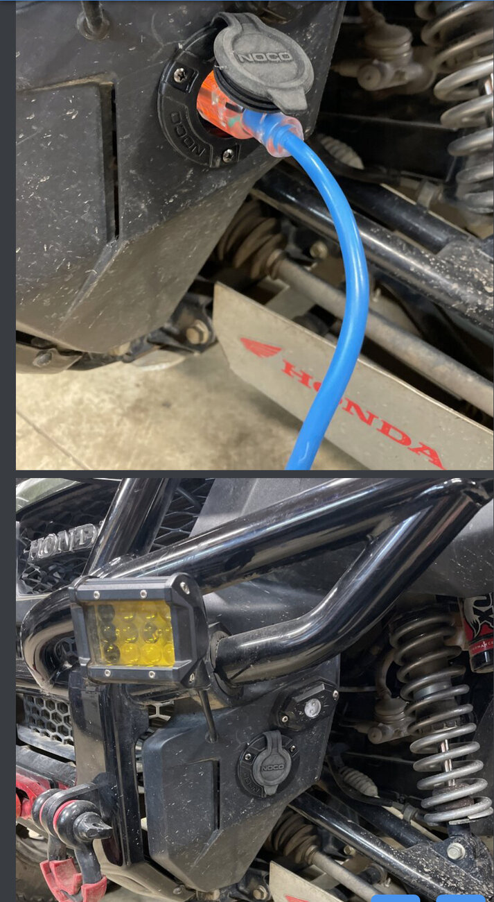

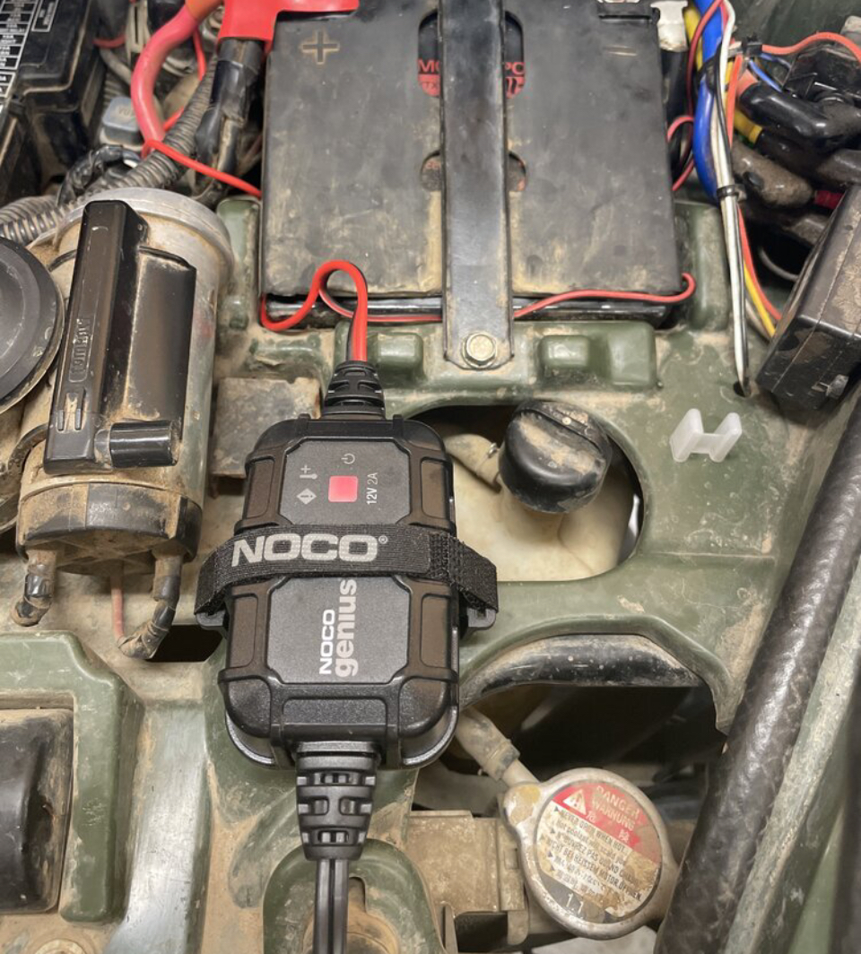

As for charging, I have a dual batt set up and u have a Norco Genius trickle charger located under the hood and a Norco water proof plug I leave the rig plugged into during the cold months at my cabin in Gaylord in Deer season and when its in my Barn at home.

I just got this set up for my Talon. It’ll be plugged in while at home. I’ll have to replace the ring terminals because the ones that came with the charger are to big.
