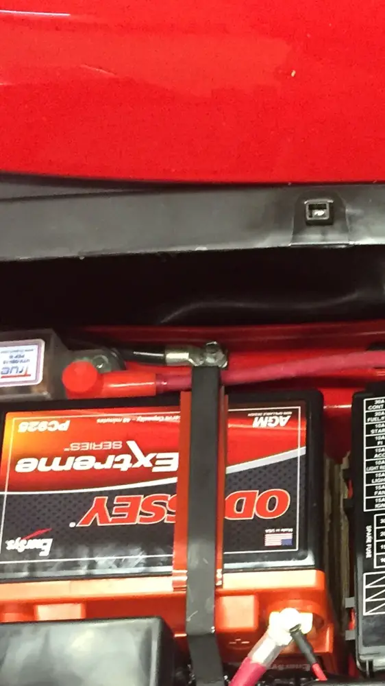

I ran one wire to the negative on the OEM battery and grounded one to the frame.
Here’s the frame ground, it goes through the plastic into the frame behind the auxiliary battery.
That's never a bad thing, but...
I guess my point is that the only reason to ground the second battery to the common ground is so the stator can charge the second battery when the isolator is "connected". In a dual battery setup with an isolator, there's no reason to send battery#2's current through the frame, engine block, etc. when the isolator cuts off. All of your draw is coming from the secondary battery directly at that point.
