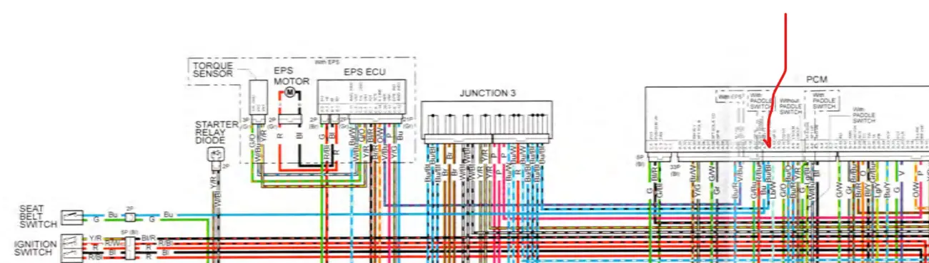

It's possible that part number ECU was used on more than just the 15 model and the inventory is screwed up. I would check your PCM for a blue wire about half way across the PCM inputs, it's likely missing. I can't read the schematic that @Hondasxs has in the club resources as the quality of page 615 is too blurry to decipher the pins. In order to bypass the newer speed limiter on an older machine, the blue wire position would need to be connected to ground. If someone had a paper copy of the 2016 or 2017 schematic they could tell us the pin number.

17 and up...
Connector A, pin 15.

That's the info we needed. His harness connector will have a plug in it for that pin. If this is the issue.
It would be interesting to know the 5 digit number before the HL3-A42
Actually, the plug will likely have a blank rubber block off and no wire if his harness is '16 or older.
The control unit may or may not have a pin there even if it's not used. I've seen them either way In cars.

I took the two colored schematics and replies to the Honda shop and told them they could easily eliminate the theory that its related to the seat belt wiring by grounding pin A 15. The manager agreed and said he would talk to the mechanic. He then said there were 3 other service orders in front of mine (even though mine has been in his shop for months). He said to check back in a week.
