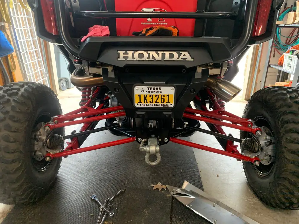

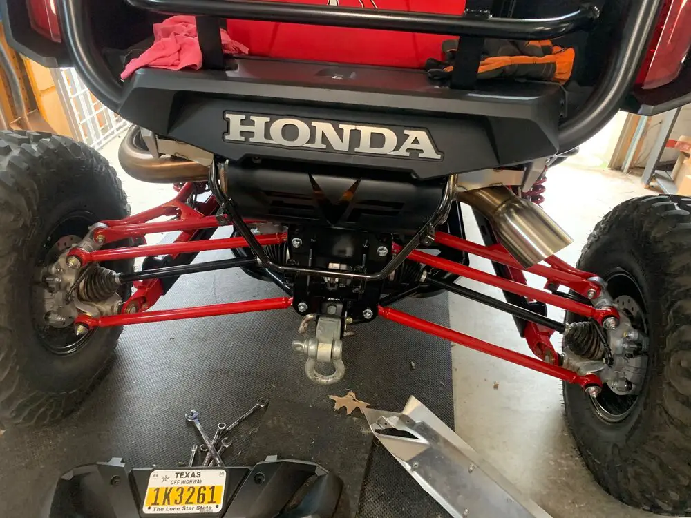

I installed an EVO i bought from another member here on the boards. I used the factory hardware and had no problems at all. This one fit like a glove. I used my factory rear cover that I cut down to keep my license plate in place. This exhaust sounds damn good!

That is exactly what I want to do. So you used the heat shield on the evo and it fit under your stock shield? Would you mind telling me what you trimmed ? A photo would be great too! Excellent job!

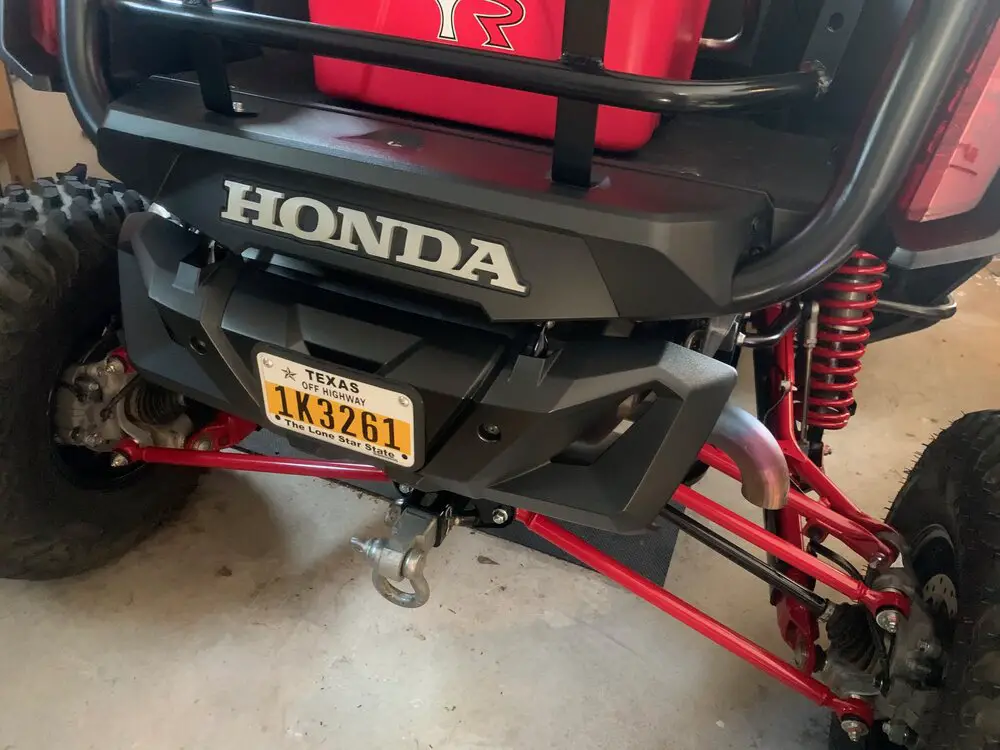

I used the EVO heat shield with the Honda bracket and plastic. I did not used the Honda heat shield. The EVO is much smaller and does not come close to the bracket or plastic. The tip on the EVO was the only problem. here is a picture of the plastic piece before I cut it. I rode it yesterday and the bracket and plastic does not get hot at all.

Thank you so much, really nice job. How did you do such a nice cut job on the plastic?

I used a small air angle grinder with a cutting wheel and finished it up with a grinder with a flapper wheel. I think you could make the same cut with a jig saw and finish it up with a hand file. The plastic piece is only $14.00 from Honda so not the end of the world if you mess up.

You inspired me, I placed the order! Thank you so much for the information and tips!
