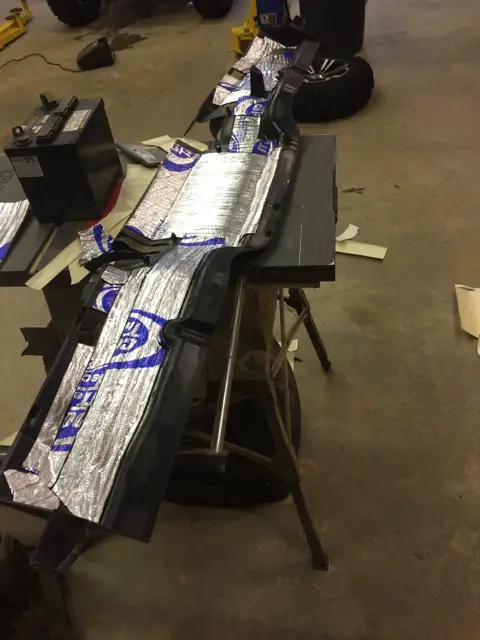

The seat belt panel helped the most but I also did the rear passenger floor and the vertical panel right behind your calf.
After all that, I added Bayouownbeer's shield under the seat. All together, it seems to help a ton.

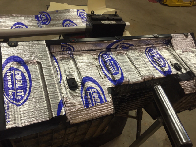

I ain't far behind you. Got it stripped down as we speak. Plastic panel is already done just waiting on the big sheet so I can make a cover to go over the engine. Also got header wrap coming tomorrow. Still debating using it or not.
IMG 20160611 213323068 800x450
