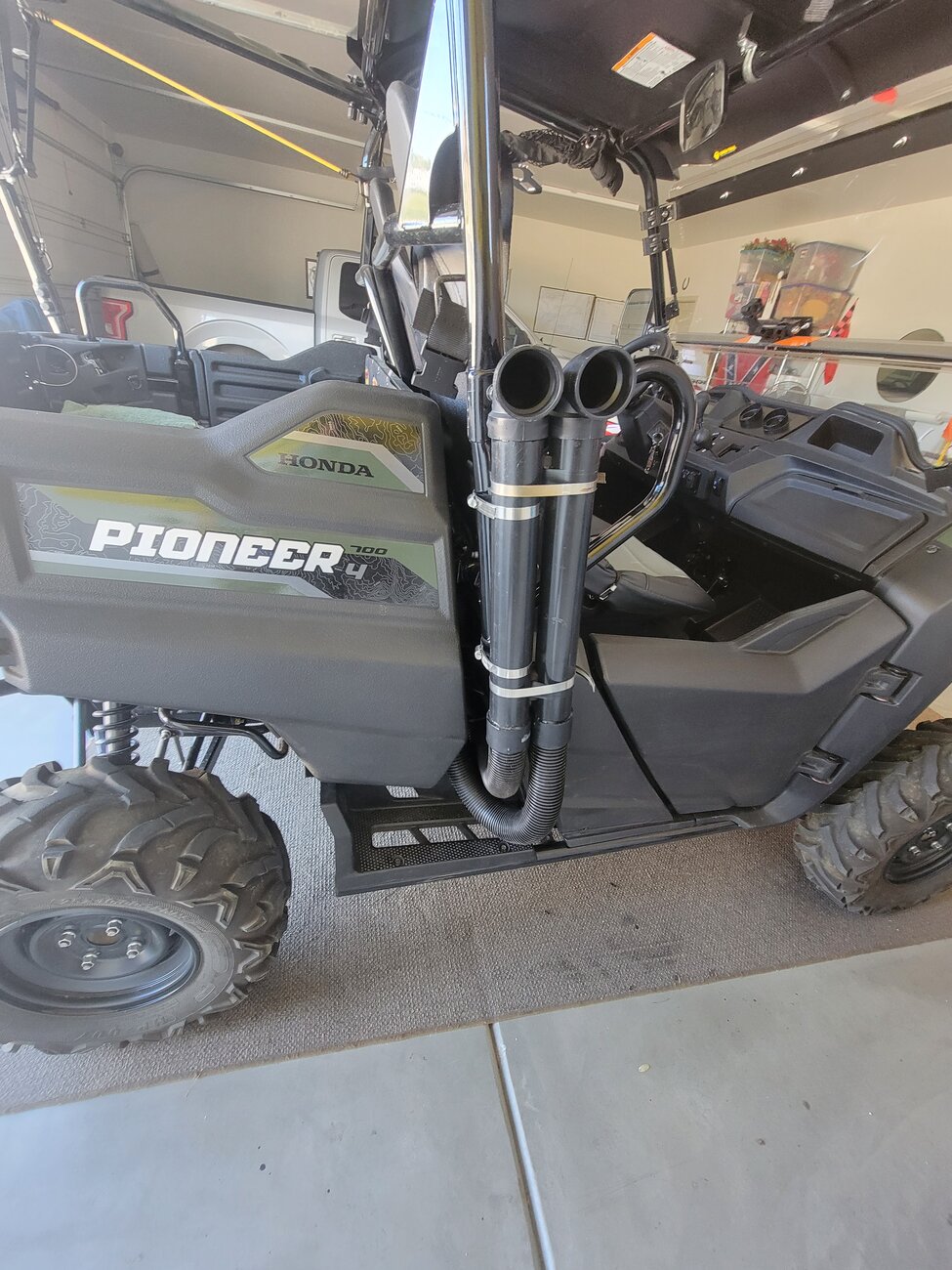

Drilled a 2 inch bulkhead fitting in stock air box for additional two inch snorkel. One snorkel alone was restricting the flow . Using shop vac 2 inch vacuum hoses for bends. Still need to clean up clamps. With tire pressure at 25 psi. GPS reads 42 mph.
🤔.... I'm not too familiar with your particular riding areas in Arizona but....... 🏜️🤷‍♂️ Is there a possibility of snagging that on something mid trail? From my water/swampy crossing experiences, snorkeling is always best done up high and closest to the center as possible. Exposed like that you might want to consider installing a head on the ends so as to avoid possible splashing........
My 2 cents...
Also, 25 psi???😳 Your roads must get really flooded.....😬

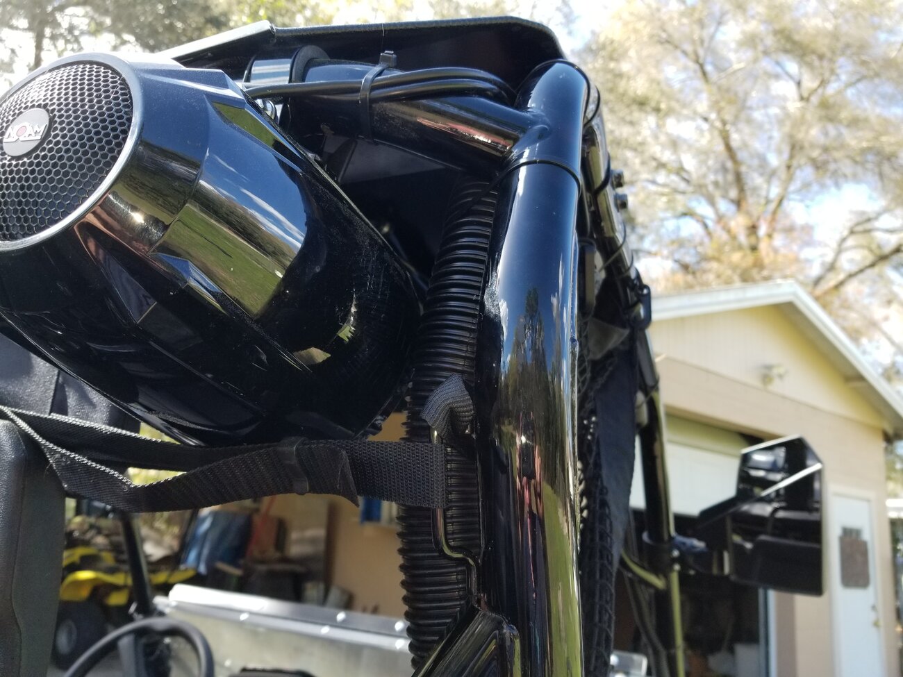

I can see that. But at armpit level it seems it would ingest a lot of dust.
Yes it would and that's why I don't do it that way. Plus in this case didn't do much IMO. Not much higher than the stock height behind the passenger. A lot of work for a little gain. As long as it is worth it to him. You almost can't tell mine is there. I didn't do it because I use it as a boat. It was for just in case.
Looks good that way.
