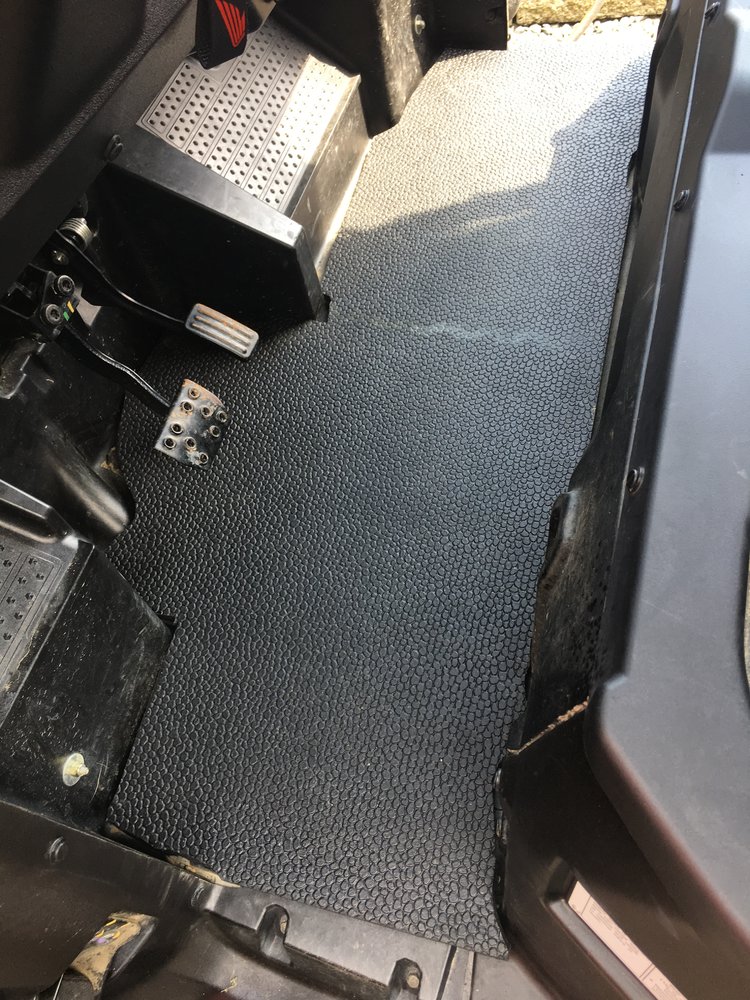

What did you cut them with? The ones I say were heavy an about 3/8s if I remember right.
It took a little finesse.I had a piece of cardboard and I made a pattern, then I flipped the mat and pattern upside down and sprayed white painted on the edges. I then laid it down and cut on piece of plywood.A couple of trim cuts and it laid down nice.
Just be careful and don't try to cut through at one slice.the mat was 2'x4' for 24.99
And I have enough for a second one.

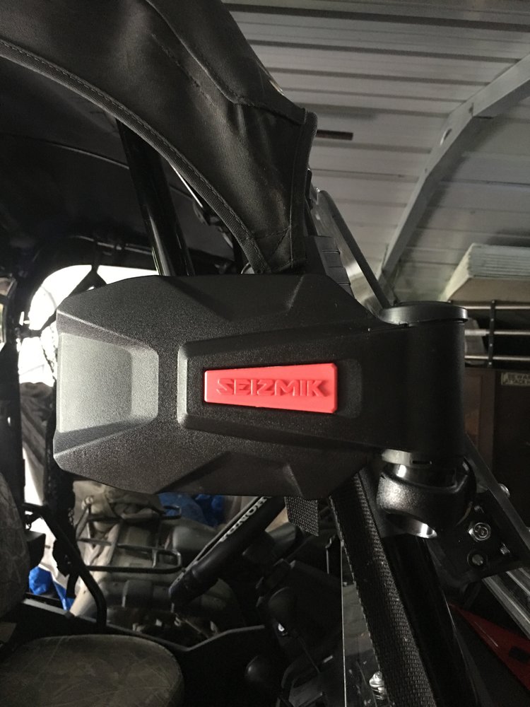

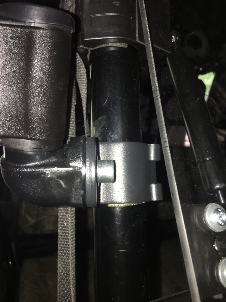

swsebek,
looking at getting I think the same style mirrors see link please.SEIZMIK PURSUIT SIDE MIRRORS 1.75in diameter Lifetime Warranty HONDA PIONEER | eBay
are these what you have how to you like the fit on the roll bar?
No mine are the strikes. But they look alike they are 65 bucks. And they are composite plastic. The pursuits are aluminum.They will fit the 1000 ROPS better. I had to shim mine. The 700 has a 1 5/8 dia.bar.
They are good quality and I'm very pleased.The sight area is nice

View attachment 78459 It took a little finesse.I had a piece of cardboard and I made a pattern, then I flipped the mat and pattern upside down and sprayed white painted on the edges. I then laid it down and cut on piece of plywood.A couple of trim cuts and it laid down nice.
White paint on edges?
You could use a sharpie marker too. The paint makes an outline of the cardboard so you have a outline to cut.
