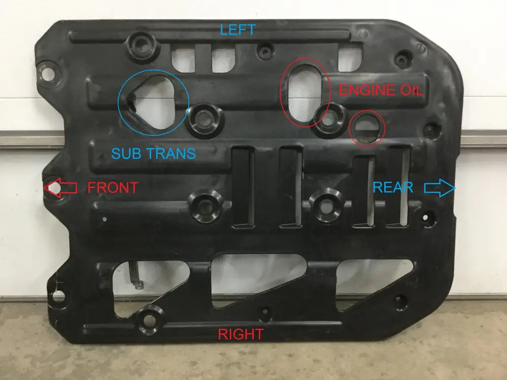

The Trail Armor skid in my Talon (same basic engine) has a very narrow slot for the 17mm drain bolt (red oval circle) and I'm surprised how little 'runoff' I get. The 12mm bolt (red round circle) doesn't spill any at all. You have to drain both for an oil change. Note that the two engine oil drains are fairly close together, maybe 5", the sub trans is further away, maybe a foot forward.
The Talon is spec'd at 6.08 qts. .08 qt. is 2.56 oz. - so 6 qt. 3 oz (engine oil and filter only). 6.1 qts. if also changing the DCT filter which becomes 6 qts. 3.2 oz. Not sure the Pioneer is the same but just in case.
Be sure to have a catch pan under the two filters, there's at least 10-12 oz of oil waiting to dump on yer foot. :oops:
The stock Talon skid -

There are 3 drain plugs. The forward most drain plug is the sub-trans. You will want to drain the other two. Put some shop rags/towel under the filter covers as they will make a mess when you take them off. I don't drop the skids when I change the oil. Don't use an impact when you tighten the filter cover bolts and they only need to be a hair more than hand tight.
The Talon is spec'd at 6.08 qts. .08 qt. is 2.56 oz. - so 6 qt. 3 oz. Not sure the Pioneer is the same but just in case.
