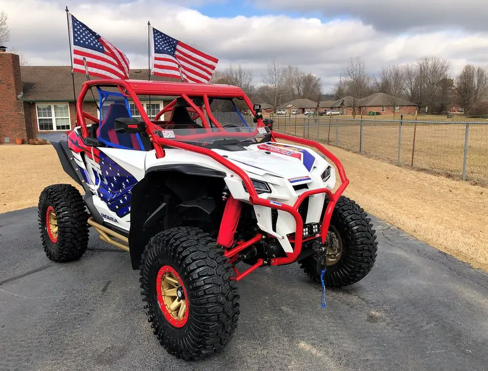

I wasn't impressed with the Honda bumpers. Decided to go with HMF on both ends. Very pleased with them. The front has the winch mount built in so no need for any extra brackets. I'm running the Super ATV Black Ops 4500 but the Warn will fit perfectly also.

The A pillars are a known weak spot in the Talon structure. The EXO bars connecting the font bumper to the A pillars serve to triangulate that structure to reinforce the pillars.

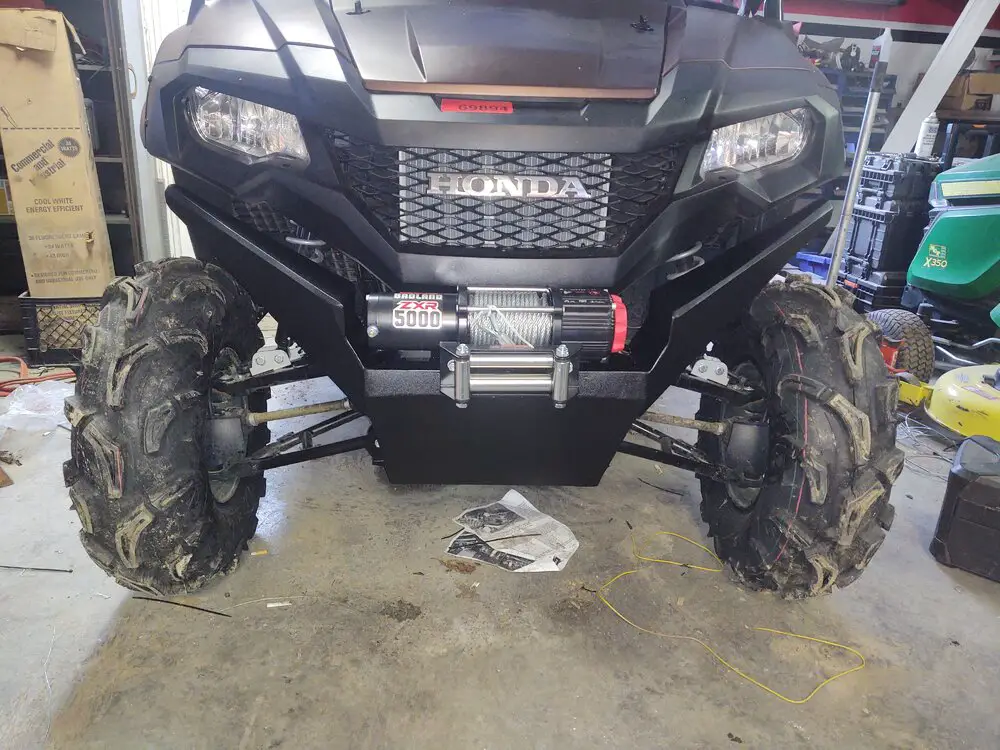

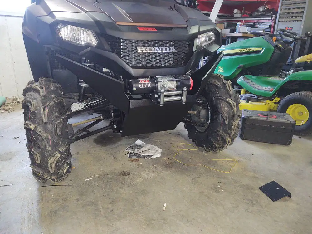

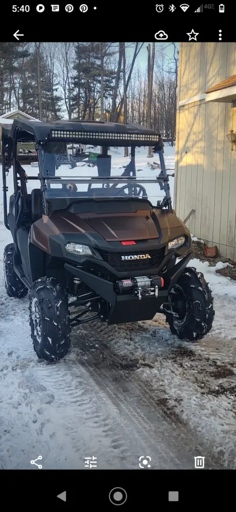

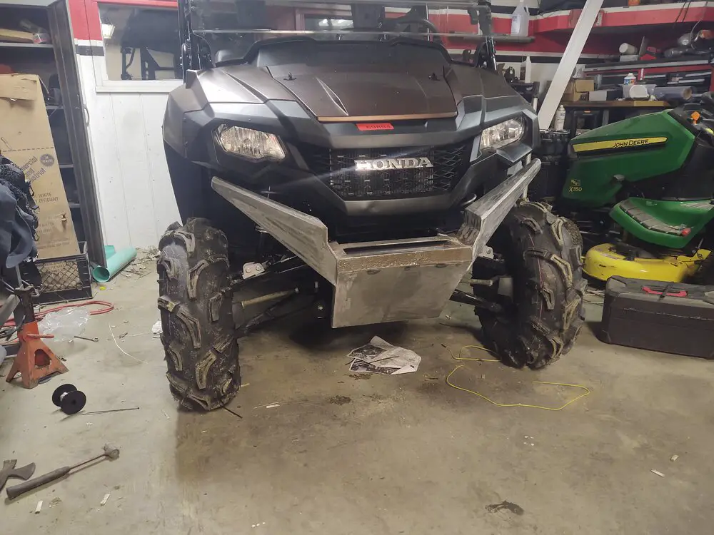

I just made this bumper for my 700-4 it came out pretty decent super heavy duty through a harbor freight 5,000 pound winch on it. Cost about 150 bucks in material plus the winch and a few days of welding.
