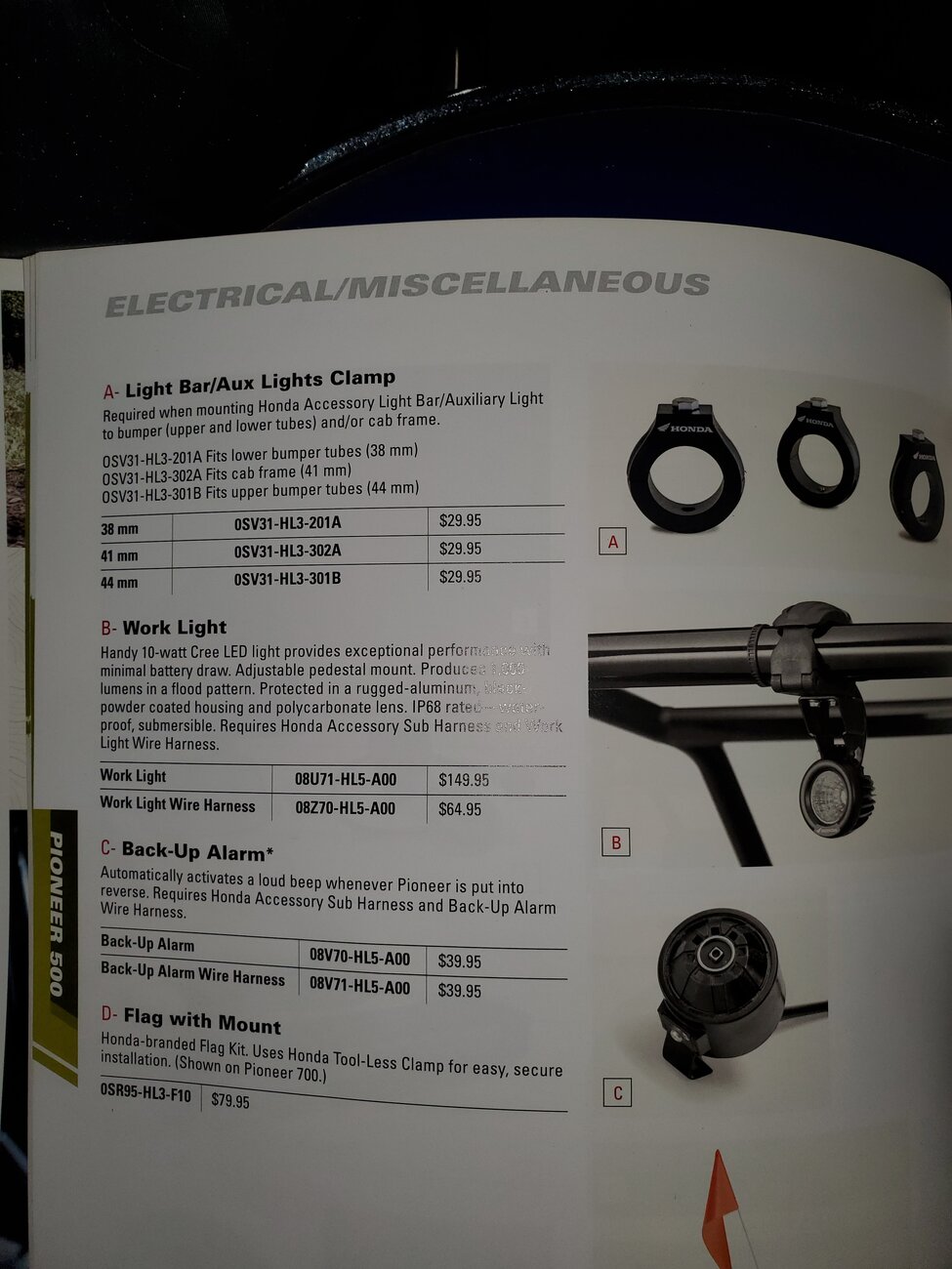

I have researched and cannot found what diameter the front pipe is on a P500? I am thinking that I would mount a set of lights to it. If anyone could point me in the right direction. Thanks.

This is the size of the clamps are that Honda sells, its an old book so the prices are probably different but the sizes are there
