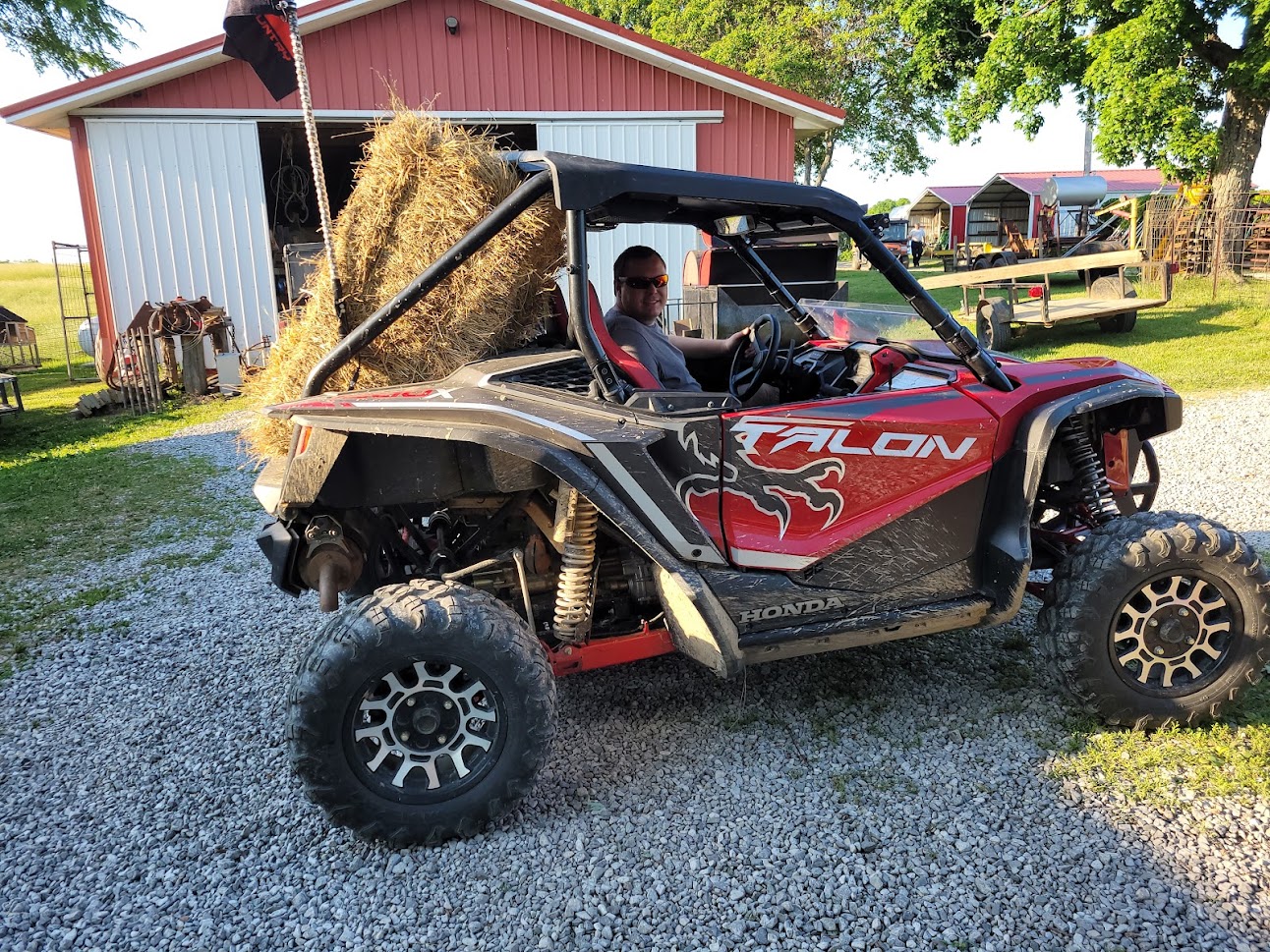

that all seemed like a ton of work, im lazy, went up high
IMG 6085
