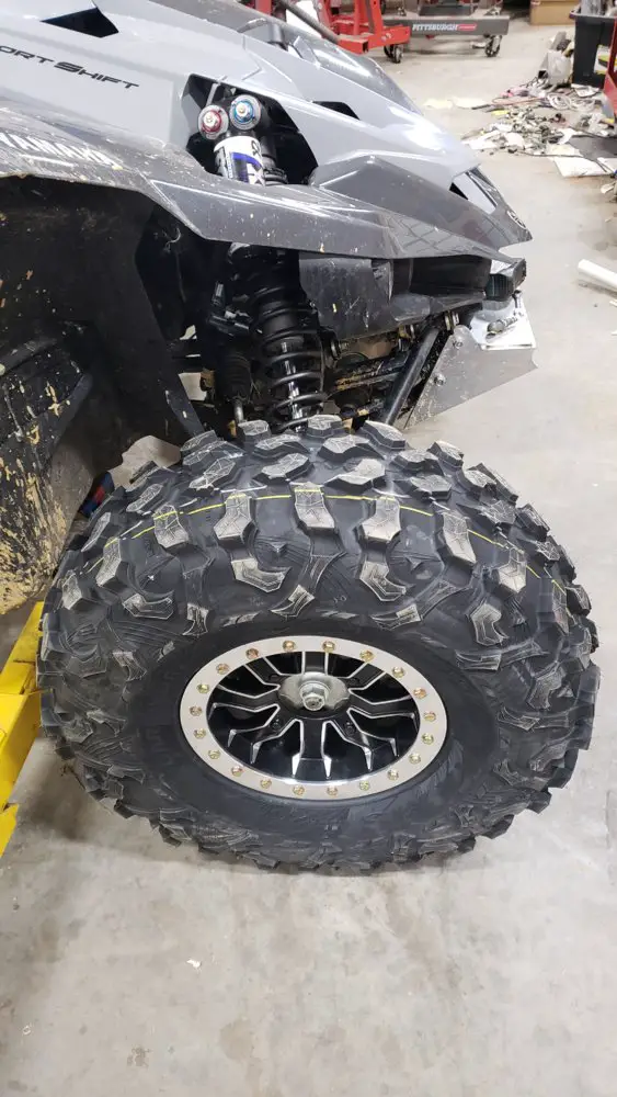

A 32” Terrabite and a 32” Carnivore. Both unmounted.
0b0f271630aba16d485b35b2e5dad84e
Just in case anyone was curious. Both measure 32 at 18-20 psi and both are short obviously at ~10psi.

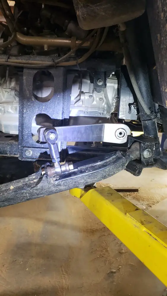

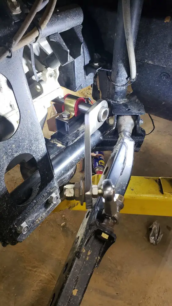

Mocking up a custom rear sway bar setup. The stock bar is awesome for faster riding but not so much for flex. I'm hoping it will give me enough sway control but still be able to max out the flex. Its a circle track bar with splined ends so I can change bars to a different rate easily. Stock bar was 1.25" dia. This one is 7/8".

I figured you had a button that disconnects it like a power wagon

A lot of the canam guys run those mini shocks on their sway bars. I’m assuming for flex?

Yes. They are adjustable so you can tighten the damping to make it act like a solid link or loosen to let it extend. I mentioned that to your buddy at takeover with the x3 to loosen those off but I don't think he knew what they were for.
