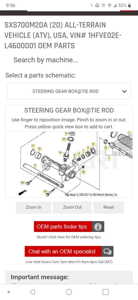

Looking at the parts fiche, the bushing is actually on the right side, so I don't know if that would do much, but I'm going to try the adjustment. Like you said, PITA to get to.

"Not" or now?
There is no bushing shown (or seen) on the parts fische on the left side. It's odd...seems largely unsupported on that side. The other side does have one, but that side is pretty tight.
the 1000 were the same way only supported on one end with a plastic bushing. we took them out and replaced with one on each end with an oil embedded bushings. the
