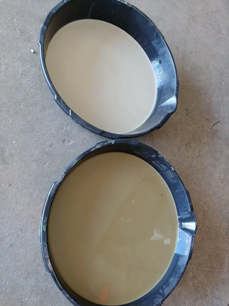

0713201446
sub trans 1 1/2qt's on the top... engine & dct 7 1/2qt's on the bottom
front diff looked good... rear diff had a little water
Siphoned gas very little water.
I started to drain coolant but after looking/thinking isn't it a sealed loop system? Is there any way water could get in? If so wouldn't it be obvious at the overflow tank?
Difference in color isn't it the same oil?
Honda calls for the same type of oil in the sub trans, and the engine/DCT, but the systems do not exchange oil at all. Completely separate cases. Only the engine and 6 speed DCT actually cycle the same oil between themselves.
