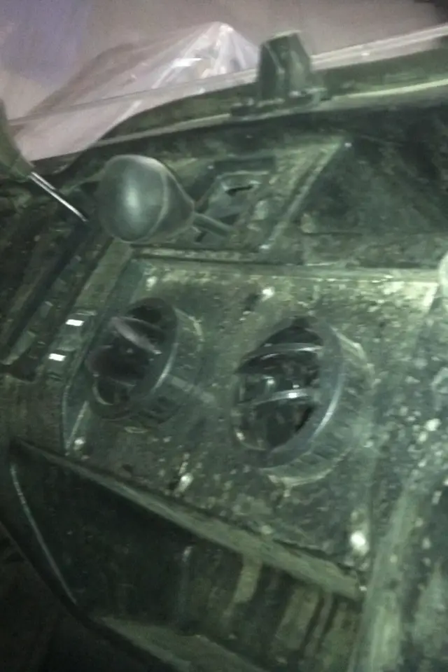

Electric heat takes an enormous amount of energy. No way the alternator would be able to keep up. Hence why they aren't used in autos. But hey...at least you're thinking! I cut holes in my "death certificate" on the dash and installed auto dash vent from Summit racing. That, coupled with my ram air hood, allows ambient temperature to blow in when I'm moving. When it's cold, I simply close the ram air and the air that rushes through the radiator blows through those same vents. Works astoundingly well (as long as you're moving!)

Pics shortly...
Photo 3 Photo

The idea is to make good use of that heat that blows through the shifter slots. With these dash vents, and the hood insert removed, it blows through like a car heater. Vents are 360 degree rotatable and the louvers are fully adjustable between closed, angled so you can direct the air where you need it, or straight out open.

Damn!!! Pics really show how dirty my machine is! Shame on me!
