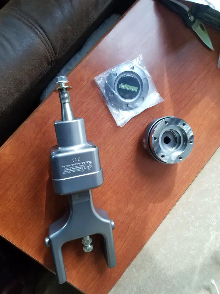

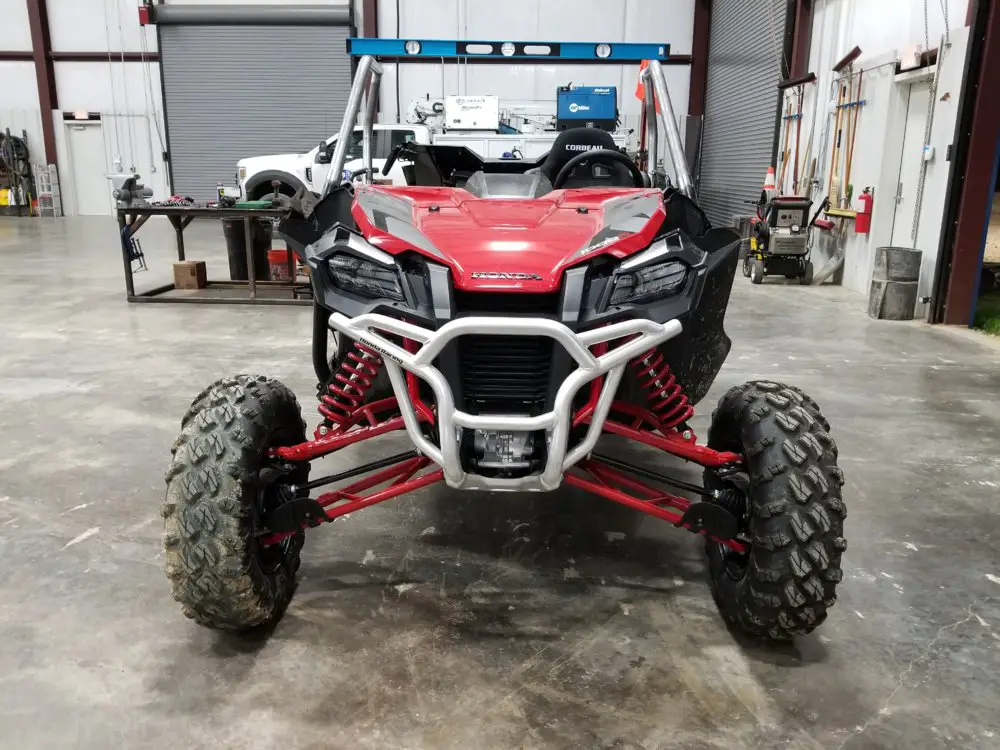

I pre-ordered a Hess steering quickener a month ago in preparation for my coming MX/GNCC build. I got a tracking # on Thursday and the parts showed up Friday afternoon. This thing is a work of art! It's almost a shame that half of it is hiding under the dash. Lol

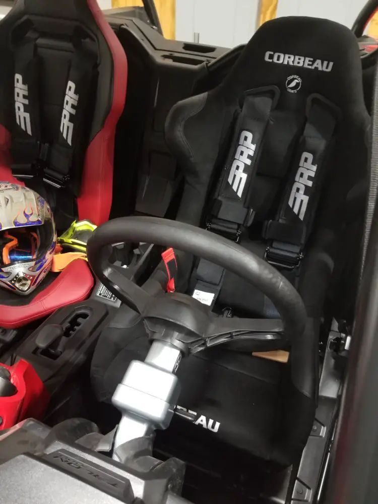

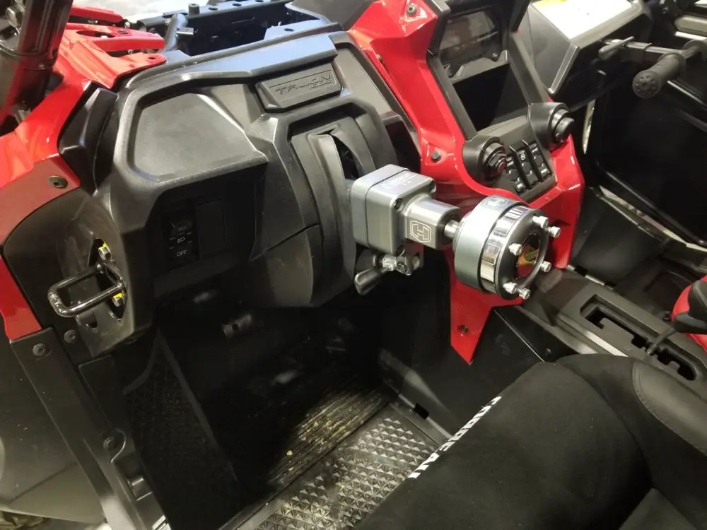

Installation was simple enough: Remove hood and cowl, remove rubber boot around steering column, unplug the paddle shifter connector and pull wiring out towards steering wheel, remove the nut holding the tilt cylinder, remove the bolt holding the steering shaft to the P/S unit, remove the two pivot bolts holding the column in, remove the tilt cylinder bolt and pull the assembly out towards the dash. The column will have to be tilted 90° for the wide part to fit through, but other than that it comes apart pretty easy. Swap the steering shaft over to the Hess unit and reinstall in reverse order. Easy peasy.
There are no provisions on this unit to install the paddle shifters. You can run the machine in auto/sport mode without the paddles, or like I'm doing, buy an aftermarket steering wheel, a couple of 1" momentary buttons and a dual push to talk button plate and wire it up yourself. Hess is working on a plug and play shifter button setup similar to what I'm going to do, but as of now it's still in the testing stages. For testing I reinstalled my stock wheel. The new steering wheel, buttons and mounting plate I ordered will be here late next week.

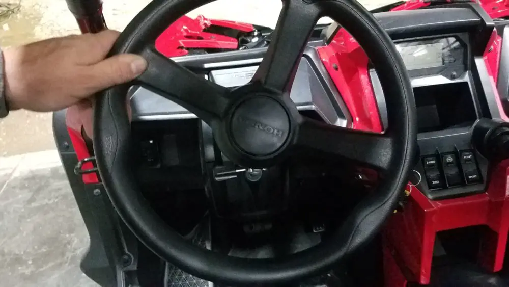

After installing the quickener I took it for a short ride around the shop. It's a HUGE improvement over stock! It's going to make tree dodging, tight cornering and drifting much easier. IMO, this is going to be a must for anyone racing their Talons. I attached a picture below showing the wheel at full left lock. It's just about 3/8 of a turn from center, and 3/4 lock to lock.
I'll update this thread at a later date to let everyone know if the power steering unit is still happy being turned twice as fast as stock. Hess said they have not had any problems with their test units and I don't expect any problems with mine.

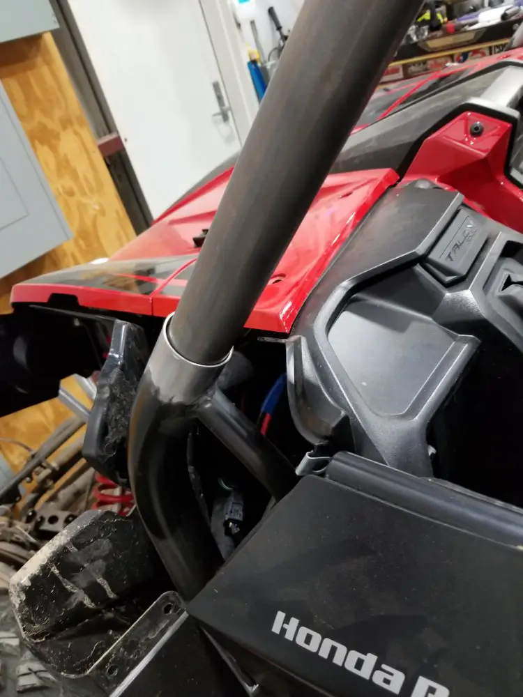

The cage bungs on these are complete piles of $hit. I would not trust my life with a cage bolted onto the stock pieces. I've used proper tube clamps before in the circle track and offroad world, and Honda's idea of one is a joke. Anybody building a cage off the 4 stock bungs is putting their life at risk IMO.
My B pillar bar is slid inside the entire length of the stock cage and will be plug welded in several spots. A pillar is getting a similar treatment. I've seen 2 LOORRS race Talons and both cages on these machines were built like mine. No clamps and non removable cages.
Check out Hans Ada Motorsports on FB. He had Geiser Bros (TT Builders) build his LOORRS legal cage. I'm doing something very similar....

What is a steering quickener, and what’s the improvement with it? Thanks
It speeds up the steering input and keeps you from having to cross over your hands for tight, full lock cornering. The box I bought is a 2-1 ratio. So instead of being 1.5 turns lock to lock it changes it to 3/4 turn lock to lock.

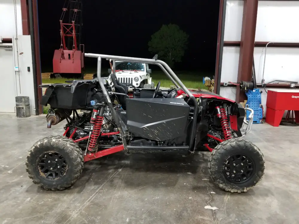

Almost done. Just need to put some of the body back together so I can bend up and install the door bars.
My exhaust should be here sometime next week, and I'm about to call Hess Motorsports to check on a rear mount radiator kit...

I already have the hess steering wheel and a steering wheel disconnect from sweet msg. I am looking to get the 2:1hess quickener will the puch buttons work with the wheel disconnect? I need to use the buttons for launch control.
Ya. I disconnect the wheel and set it on the dash with the buttons still plugged in so i have room to get in/out. When I wash it I go under the hood and unplug the connector so I can pull the wheel completely out of the car.
My short course thread has way more detailed info about the installation of the buttons and wiring. I had honestly forgot I even made this thread until you bumped it. Lol
