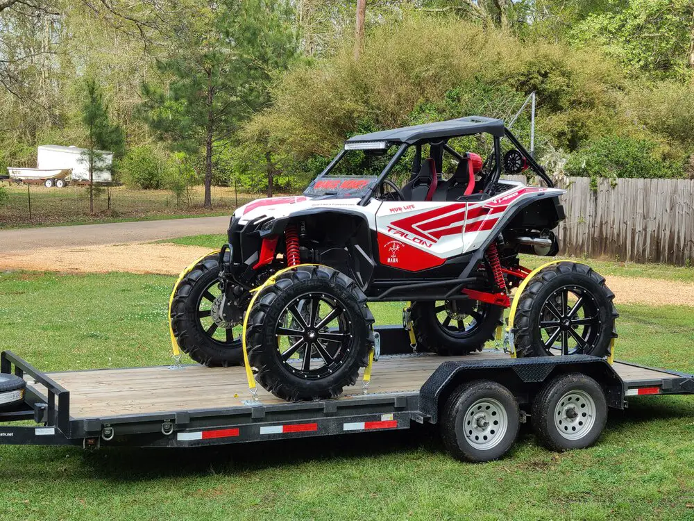

My babby

I love it it dont move at all i would recommend doing it thats the best way to do it
