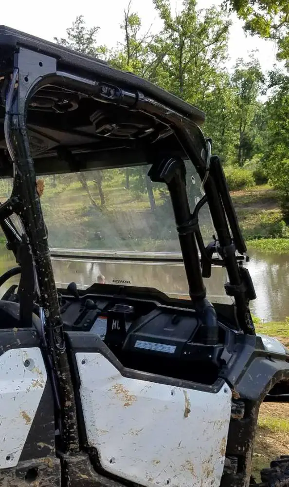

I've added the instructions for the high lifter snorkel installation. The pictures are of my installation, I routed all vent tubes to the roof instead of drilling holes in the roll cage. Hope this helps.View attachment 42446

I really like the thru the hood option as it's soooo easy to do and to access for changing to this pre-filter in dusty conditions. I don't know about the LE plastic but the hood for the standard deluxe model is about $45..
