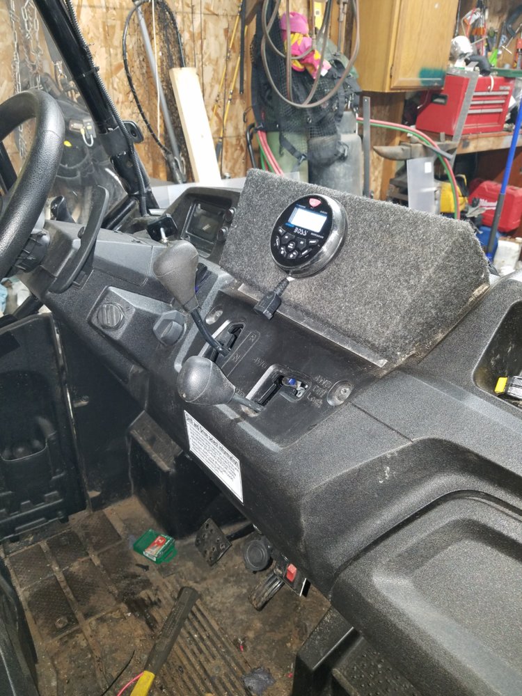

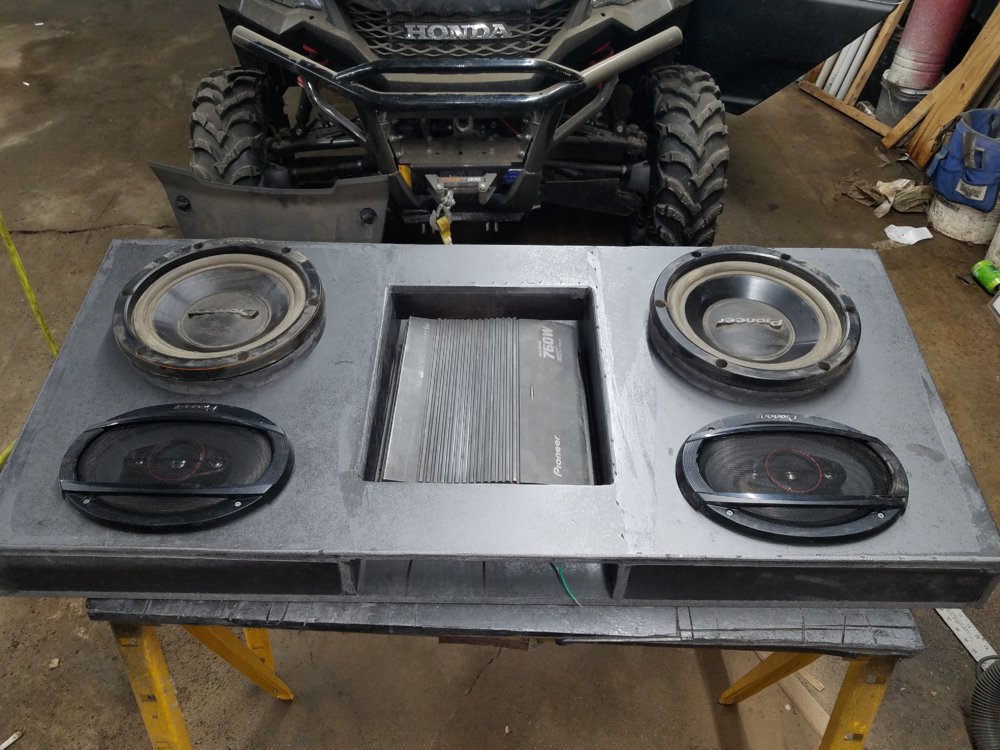

Backwoods- sound is perfect- crystal clear , TONS of Bass, load as Hell!! goes up to 40 I think but cant sit in there past 25 HAHA..BOSS marine head unit is AM/FM , Bluetooth also -so I use Pandora or Spotify .I'm currently running Pioneer 760 WATT and thinking of adding another 760watt so I have to power only Subs- Some have asked if it weather proof.....only head unit. the roof system is not, but windshield and roof protect.

Alloutdoors- no the roof system is not weather proof- but there is a roof over top ,windshield and back window to protect that as well. The head unit is weather proof- BOSS Marine MGR350 -crystal clear output

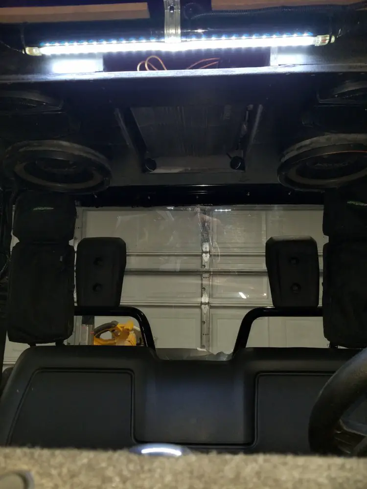

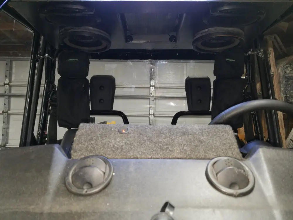

FINISHED!!! NOAM NUTV4 QUAD.... also routed a remote aux cord outlet in glove box... sounds awesome.
