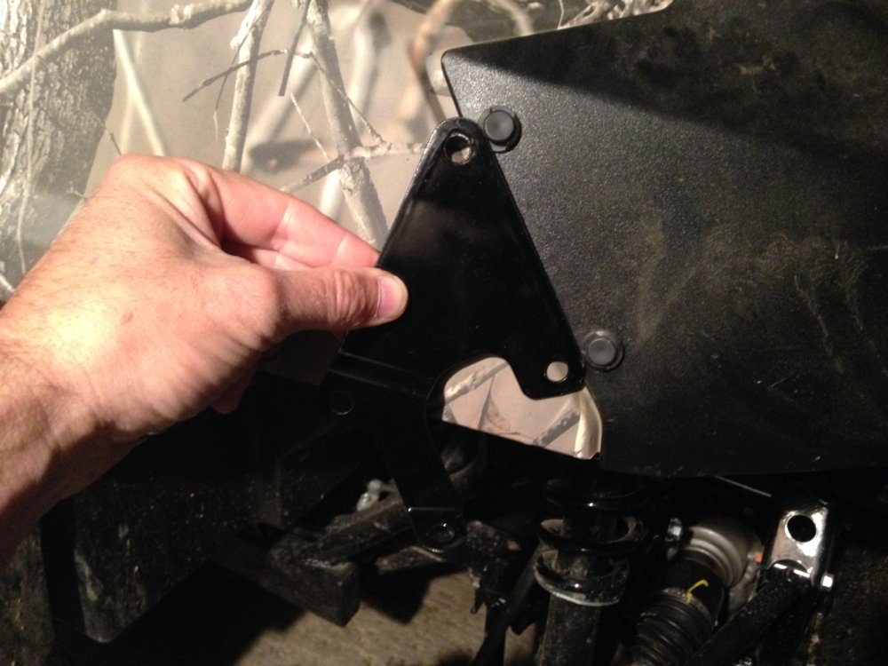

Install bracket first.(behind fender of course)
IMG 0749

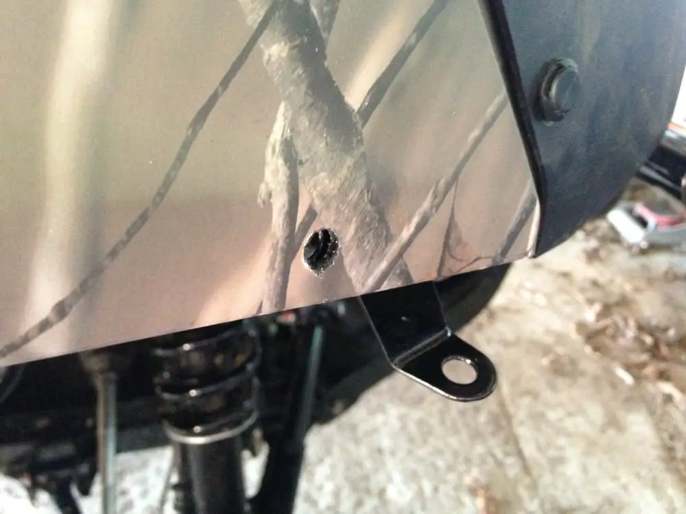

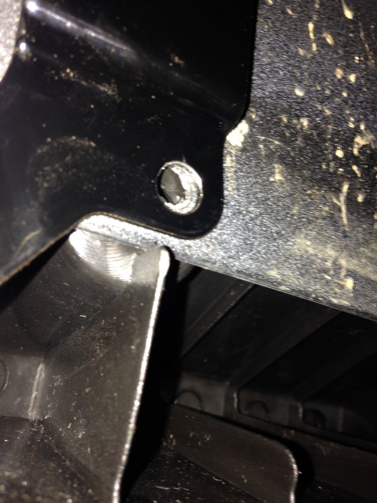

Drill from underneath(or back) of the fender through the bottom hole.
IMG 0751

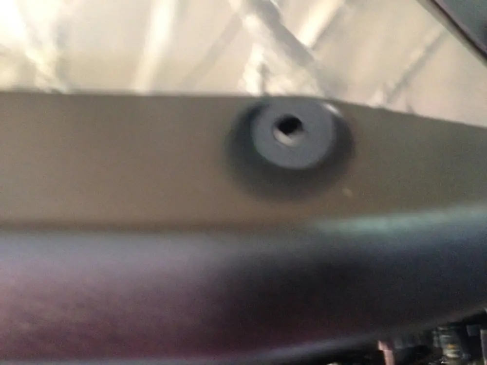

The hole may not line up... Neither did my camera.
IMG 0752

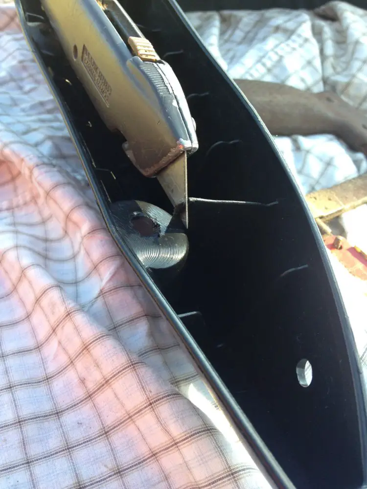

So I shaved a little at a time off the lip on the back of the flare...

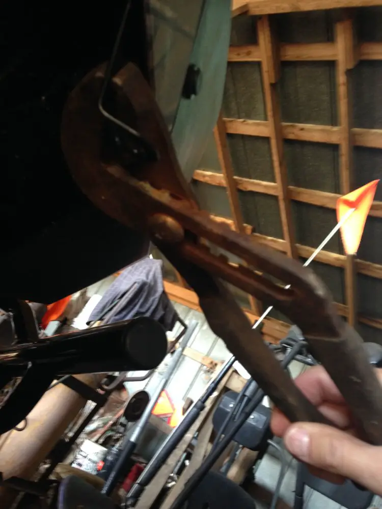

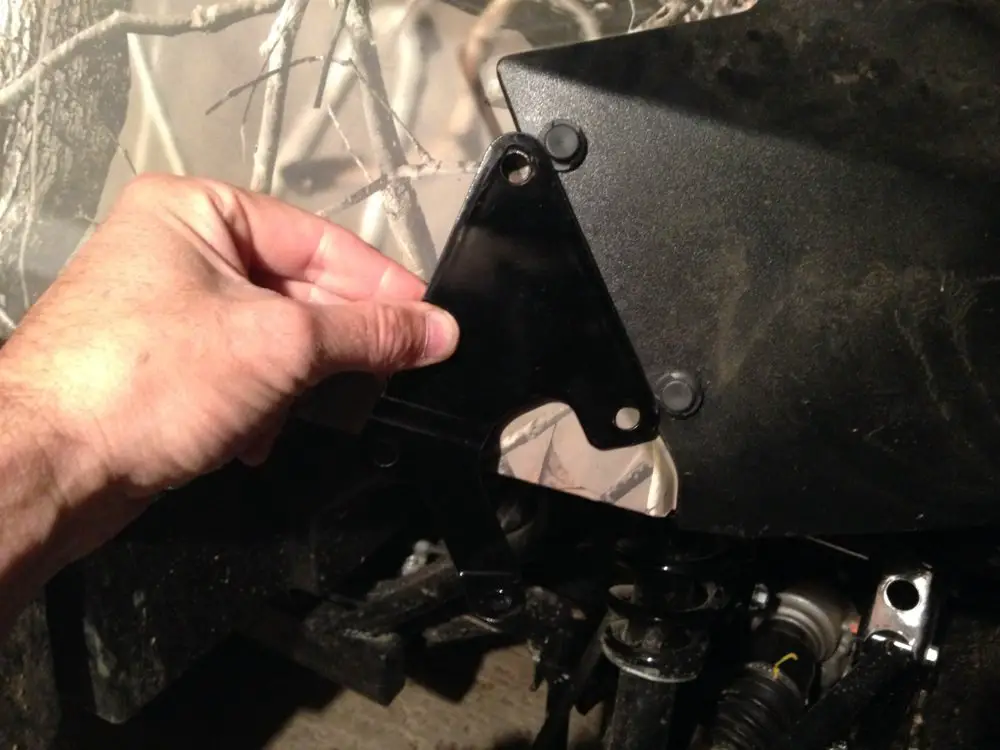

You may have to bend the bracket a little to get this hole to line up closer...
IMG 0755

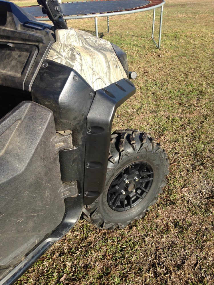

Then I drilled and fastened one hole at a time around to the bottom making sure it was tight against the body.
I wish Honda had extended them further down like the mud busters. I believe they could have. But I do think they look better regardless.
IMG 0756
IMG 0757
View attachment 30981 View attachment 30980

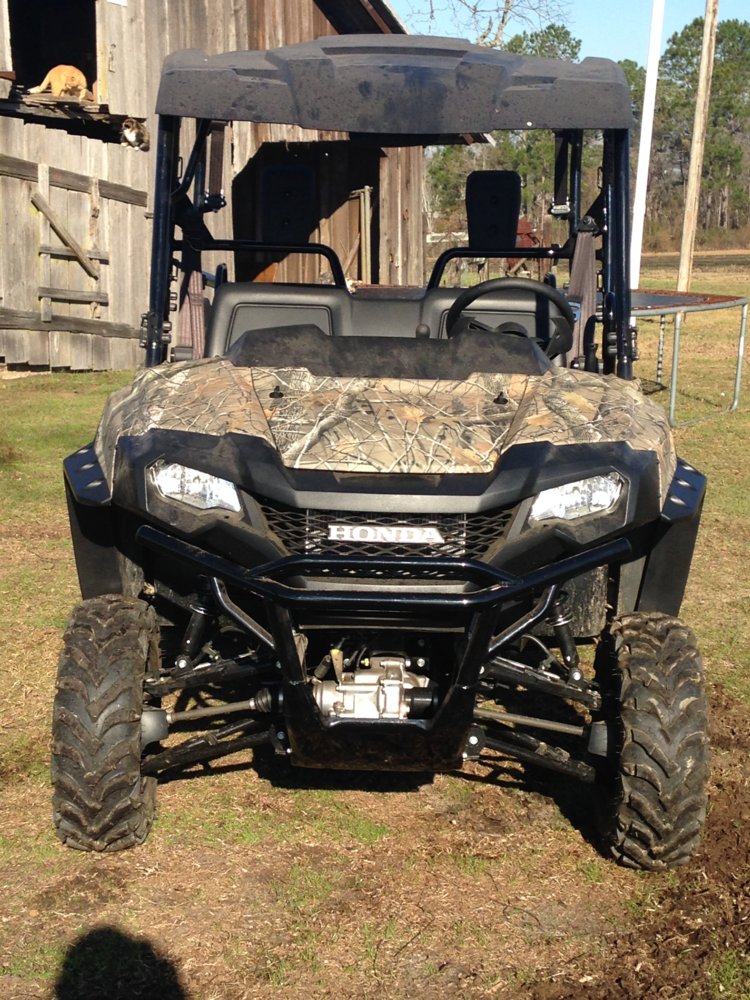

IMG 0733

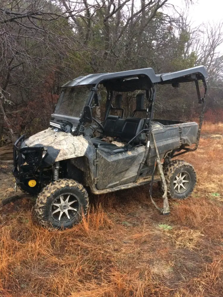

I'm in, order placed last night and sure wish I'd had them installed before this past weekends duck hunt. My Sedona Ripsaws are major mud slingers.
