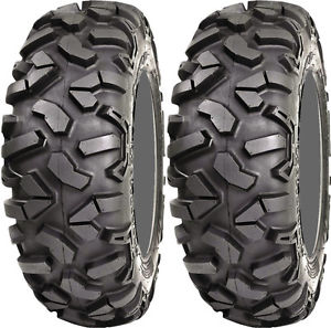

I will be going with (5) STI HD3 Machined & Black 14" wheels that have a 6"+1" offset mounting 28 x 10 x 14 Roctane XD tires. This will give me a matching spare to mount and can be run on any corner. I will keep the OEM tires and Wheels for backup.
This should get my width down to 61" so I can fit through 60" gates out West, those buying the 4+3 offset wheels are 66" wide in the front.

I Assume in order to get 61" thru 60" opening requires forcing the rubber tire to 'give'?
Sent from my SM-G930V using Tapatalk
39,848
272,267
The 60" gates aren't quite as strict as the 50" gates. Most trails that were 60" or less now are 64" max the typical width. But where I measured the 61" is the very outer most bulge of the tires.
I have yet to encounter any 60" only trails so I cannot say with 100% certainty.

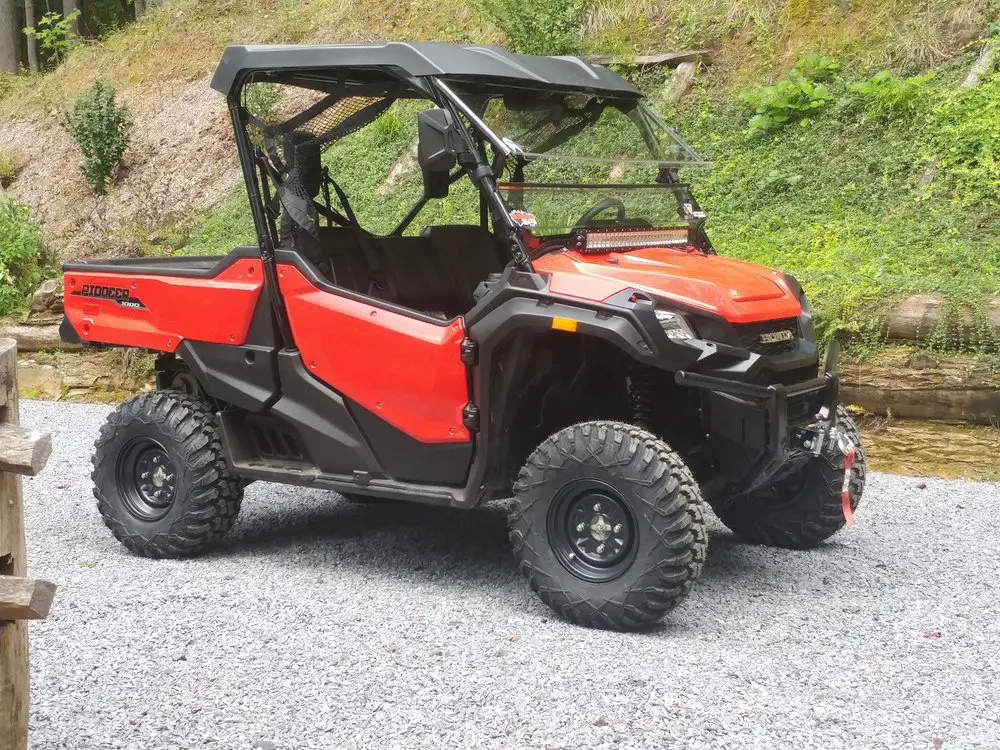

I run 13-14 psi with the terribites as per Honda . at this PSI they will tear up lawn, spin on steep gravel roads, pretty much can spin tires on command on most surfaces except pavement. I keep them aired up though, cuz I like to take this thing on the road for short trips. I'm to lazy to change air PSI .
Now if I really wanted to climb the steep A$$ hill behind my house, I would air down. In reality though probably not. When in doubt wind it out. I like it when all 4's are spinning, and the RPM's are banging at the 8k mark. :)>View attachment 61165
