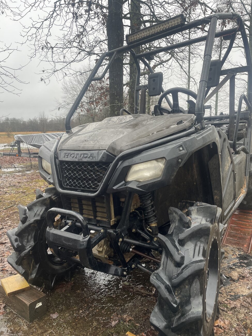

first we need pics of your machine, you may be asking for a friend

Has 768 miles, only mod is bigger tires and light bar. It was driving and the trottle cable sized up so stop driving it and replaced cable and now won’t start with no spark.
