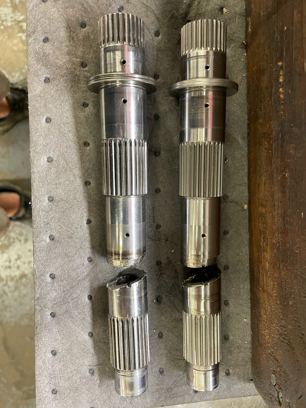

I have a buddy of mine making replacement 300M sub-trans input shafts for Talons. Some turbo and N/A guys have been breaking them racing and running hard, including the Cryo-Heat version that was supposed to be an improvement, but was not. One of these is stock and the other one is a Cryo Heat treated part. As you can see the results were the same. Both came out of the same turbo car.....
