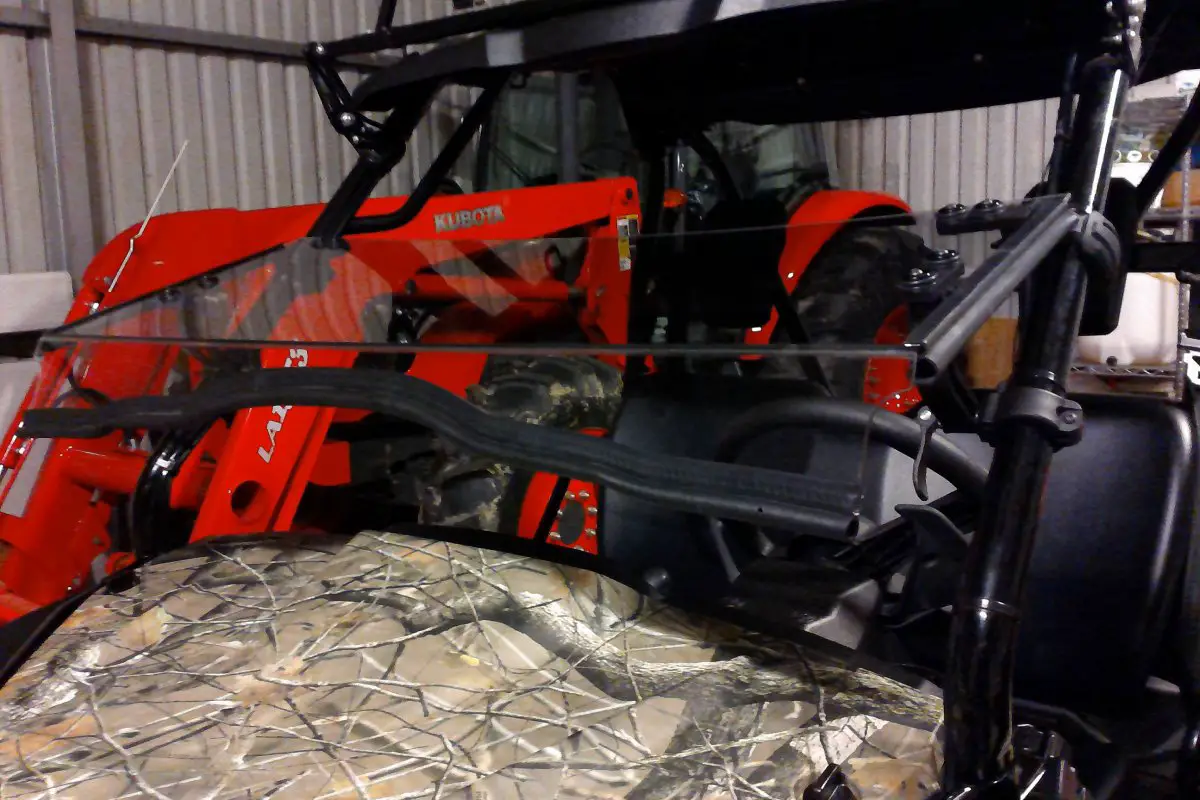

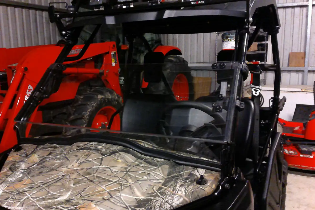

Installed Honda's full tip out windshield an first trip I realized air flow was very poor allowing back draft of dust and grass into the cab to be overwhelming. After reading all the comments posted on likes and dislikes of half and full windshields I decided to custom cut min to fit my needs. I put a strait edge across in my line of sight and lowered it wat I felt would fit my height and marked it out removed it from my P5 and cut it.. relocated the tilting fasteners, reinstalled it and it works great. Modifications reduced the cab dust with it not tilted open and with it tilted open the air flow is great.

View attachment 7333 View attachment 7334 Installed Honda's full tip out windshield an first trip I realized air flow was very poor allowing back draft of dust and grass into the cab to be overwhelming. After reading all the comments posted on likes and dislikes of half and full windshields I decided to custom cut min to fit my needs. I put a strait edge across in my line of sight and lowered it wat I felt would fit my height and marked it out removed it from my P5 and cut it.. relocated the tilting fasteners, reinstalled it and it works great. Modifications reduced the cab dust with it not tilted open and with it tilted open the air flow is great.
Got pics?
Nicely done! One question - what was used to cut windshield? Thanks...
