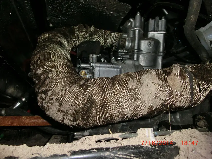

Here in California i ride in temps ranging from 105 degrees to the teens. I installed a sound deadening and heat reflective "hood" mat from Jegs on the entire seat bottom area as well as insulated the gas tank air intake and air box with this tech. It allows for a cooler intake temp and as well cuts down the radiant heat put off from the motor. The sound was quieted down much as well. I also took a rubber garage mat say 1/8" thick and made a heat/sound/dust shield that runs under the seat up the back of the roll cage too. It cut down the amount of trail dust coming into the air intake area. I hear the intake resonance more than the motor at times now. Also i installed header wrap on the exhaust tubing and heat is a non issue. Gets a little cool in the winter though! Most of my riding is spring through fall so not a big deal....just wear more clothes. During hunting season I'll drive all day at low speeds and the seat never gets hot. This is all installed with full undercarriage skid plates too so air flow at low speeds can less and increase temps. The most bang for your buck would be header wrap and heat defective material around the seat area...

Did you take the header off to install it?
No I did not. I did take all the factory heat shields off of the pipe and wrapped it directly from the head to the muffler. I used DEI titanium header wrap. 2 rolls i think 25-50' each for tight wraps. This dramatically cut down the heat. I also used Jegs brand hood liner material and insulated the entire seat area as well as the gas tank and intake assembly which quieted things down and keeps it all very very cool. Also I used a vinyl garage mat under the seat up the back rest area to block dust noise and heat. took some time but was well worth the effort.

I installed header thermal heat wrap on mine, reduced perceived cockpit heat over 50% and decreased engine resonance and noise so much all I hear is the air snorkel intake now.
I was looking at some carbon fiber wrap from Thermo-Tec. Is that what you used? How does it adhere, and can it be removed after it's cooked on there?
