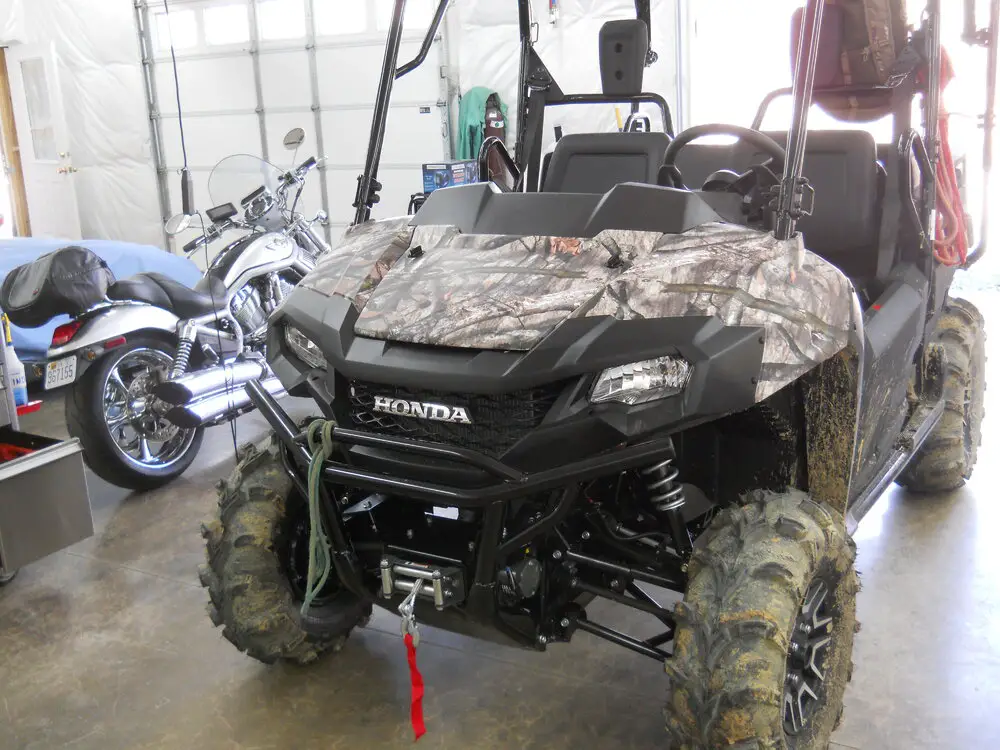

I removed each of the body panels (hood and 2 front fenders) to do mine. Not sure if that's the best method. Removing the panels made it easy to wrap but the challenge there is holding the panel while you wrap it. I ended up clamping them to my work surface. Mossy Oak Graphics sells the material in 24" and 48" widths and any length you wish up to 140" (see link below). I think I got 10' and had plenty left over. Also order the 3M primer. It's actually an adhesive. In indentions and along the edges brush on the primer for a little extra adhesion. It helps to have 2 sets of hands but I did it by myself. You'll need a plastic "spreader" like the auto body shops use to apply bondo, and a heat gun. Lay the material on the body panels with as little wrinkling as possible and work the material over the panel with the spreader to remove all the air bubbles and force it into the indentions. Use the heat gun as you work to make the camo material more pliable.
After all is said and done, the wrap was a whole lot less expensive than the difference between the cost of a camo unit vs a standard color.

It looks great. I'll be anxious to see how it holds up. I've been on the Mossy Oak Graphics website and they have quite a few different patterns.

As you can see, I garage my unit. The photos posted are after about 2 years after the install.
