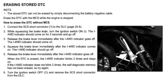

I had not read about it specifically, but it looked familiar.
A little research and, it is on page 25-6 in the 2016-2020 Honda Pioneer Service Manual.
I-4WD

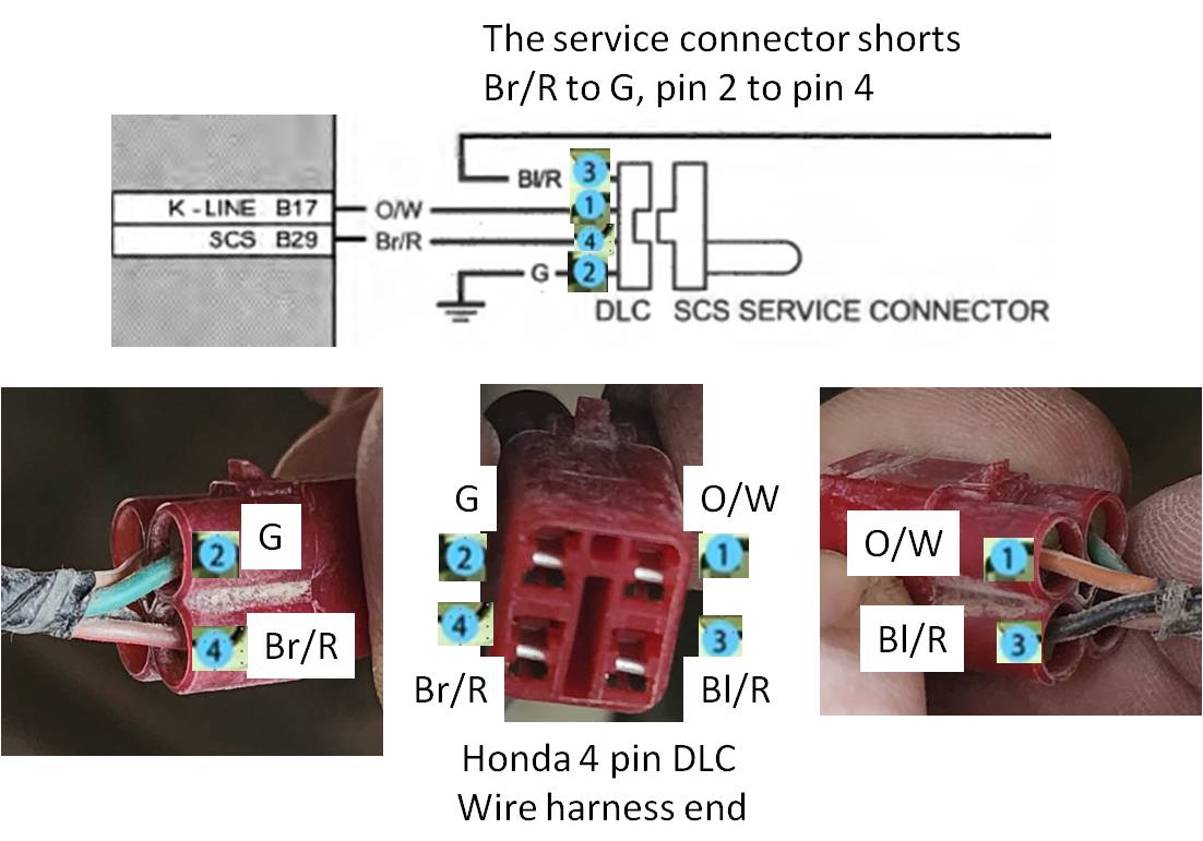

Here is a better example of that connector that he is shorting.
It looked familiar, because you are hooking to the same for reading and clearing stored codes. Page 4-8
I could not find these all in one place, so I thought I would add them. . Check Engine Light blinking, Page 4-9. . Gear Indicator Light blinking, Page 11-11. . Electric Power Steering(EPS) Light blinking, Page 24-11. . Symptom Troubleshooting, Page 4-6. . HOW TO pull stored codes, page 4-8. ...
