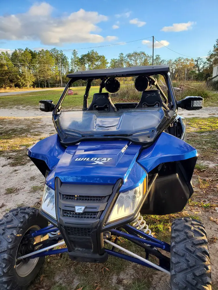

I decided to mount the mirrors then wire it in when the harness comes in. If anyone wants these there's a few things to know. They are plastic the inserts have a little plastic in front of the threads. Run the bolts in and out with an Allen key by hand I dicked up a thread a 5/16-18 tap later i have them mounted.
I have some Xrites that look very similar. They work great, I can use them riding behind someone and it doesn't blind the like my light bar does, because the mirror adjustment. Was going to do pods for side view and side view mirrors, but this works great and are bright.

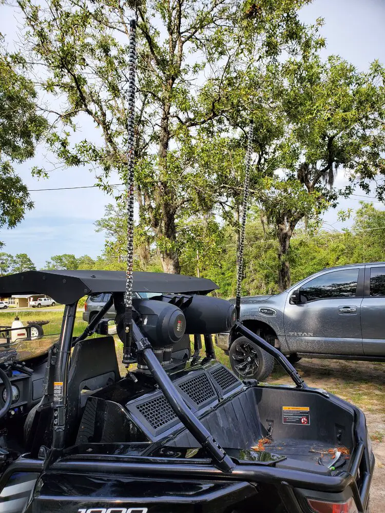

I haven't posted on here in a while I have some updates I have done to the Cat and one is rewiring everything but my stereo to a new system that will make everything cleaner.
I was a bit annoyed every accessory required a separate harness, relay, fuse and switch wired in. And being overly ocd with keeping my wires tidy. I spent 6 hours wiring in my MB Quart system. I knew there had to be a cleaner way. I found a company named Trigger. Im taking all my wiring apart and wiring everything to the trigger it handles relays, fuses and wiring with remote switches and has an app to dim or strobe my lights.

20210102 115201
20210102 115150
20210115 175835
