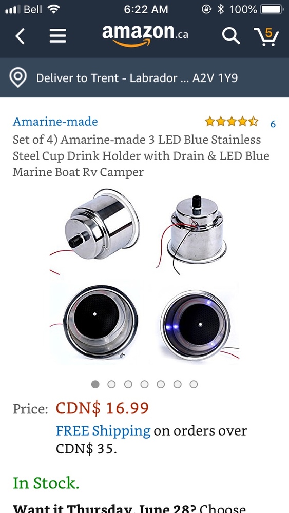

$16.99 for 4, and that’s Canadian, even got a led light to light up your beer at night lol
The led light is cool . The only issue with those is the space in the bottom of the machine pinching the wires not to mention a lot of water in there, My P1 would be a different story, cavernous in there. if one went out it would drive my OCD self nuts lol. If you go that way, I’m interested to see how they hold up?

I started this mod tonight and ran into a problem. My new Amarine SS cup holders are 3 1/4" deep. I cut the hole slightly smaller than the cup lip and thought I was good to go. Wrong. I dropped the cup holder in and all was good until I tried to push the thing in deep enough to seat the cup lip against the plastic rim and found it wouldn't go any further. It was hitting the inside of the dashboard where it starts to curve under to clear the passengers legs. I removed the cup drain spout but still no luck. It's too long. Does anyone have a SS cup shorter then mine. I'll spend a little more money to get what will work. TIA

Installed the Amarine cup holders couple of weeks ago. Everything went well except they don't want to stay completely in the hole. The lip of the cup holder radius is a little larger than the radius of the dash.
Has anyone used some kind of adhesive to help keep them in place?
I used silicone but had to grind down the back part of the cup lip to drop it into the hole.
