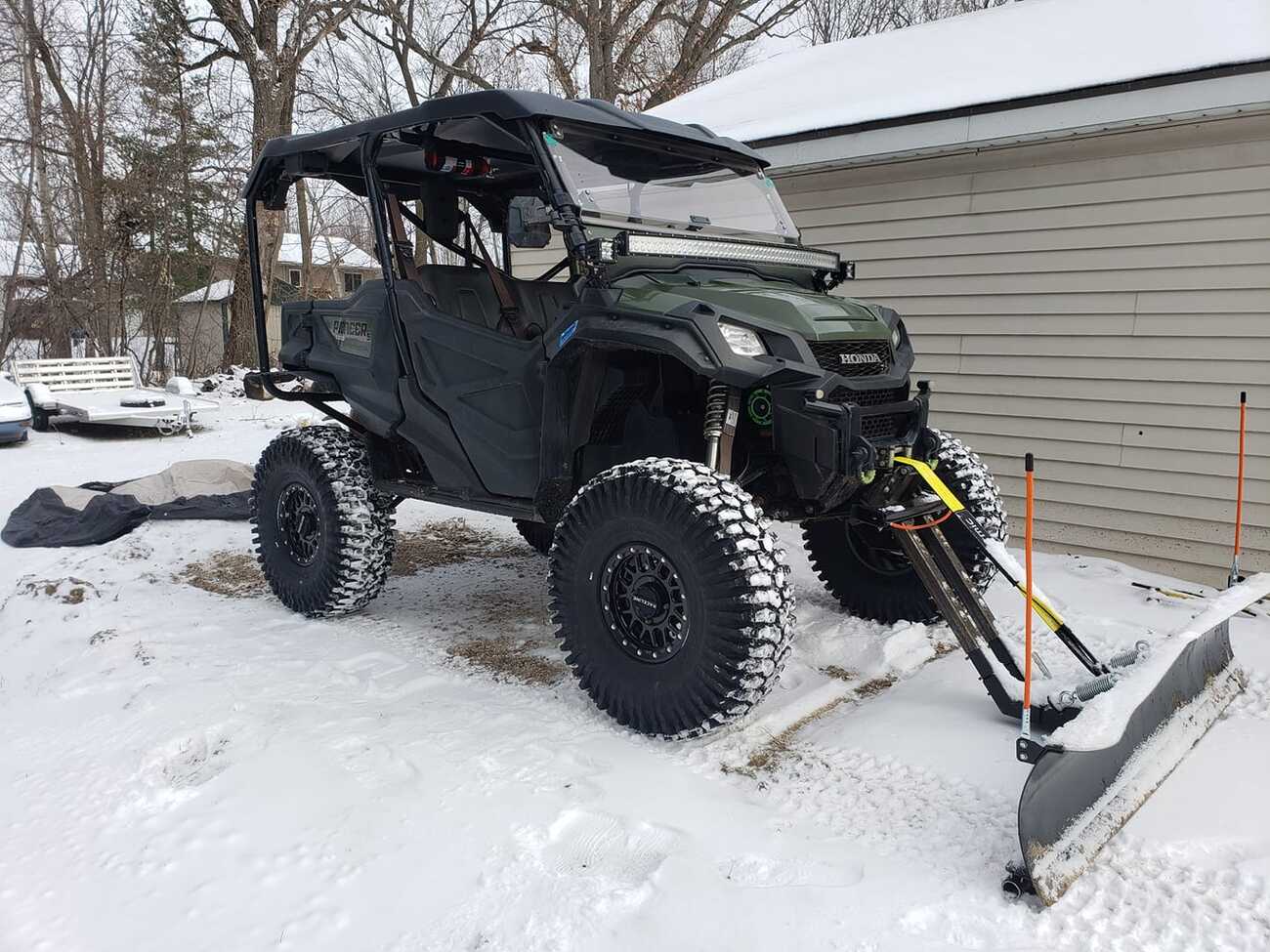

Well I have decided to go forward with a set of 15x7 / 6+1 wheels to see how it works. I found others running 4" portals with 6+1 offset on POO POO FIRE TRAP’s as well as 1 individual on FACETURD with a Pioneer 1000.

Here is the post pictures
 nc ohcniGNbNX37gQAX YPbSW nc htscontent atl3 1
 nc ohcKvkiQniQnsQAX 08Cbs nc htscontent atl3 2

Well after reading my post here, I realize it looks like i am posting my machine. THis is nto my machine this is the pictures of the facebook post that i was referring to in my previous post earlier. THis is the only example i have found so far with the 4" SAVT portals and 6+1 Offset Wheels.

are those 14 or 15 inch rims in the pictures

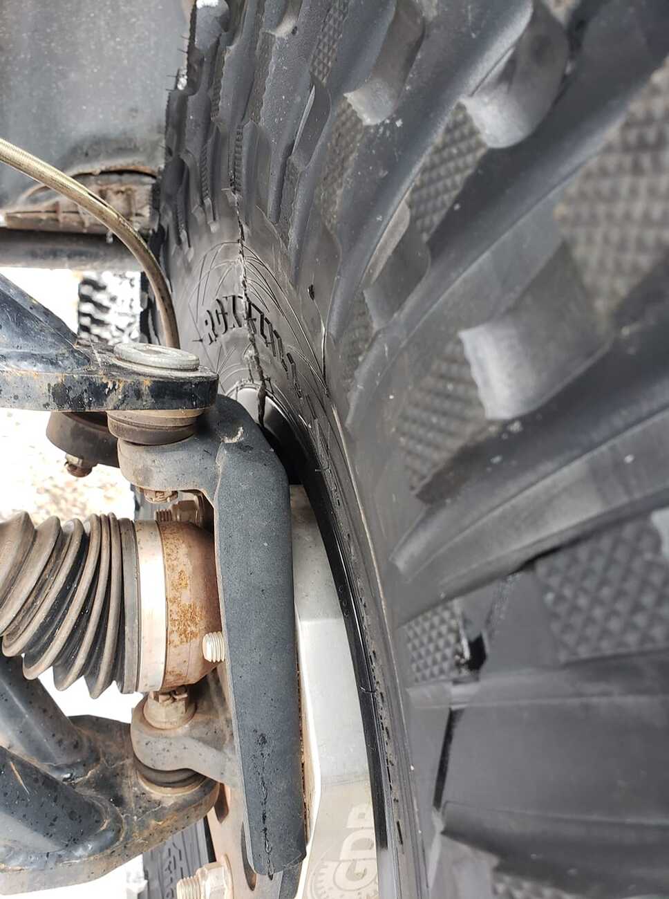

I wanted to pop in and say that sometimes rubbing can *increase* with additional wheel spacing. I know you're trying to go narrower...
